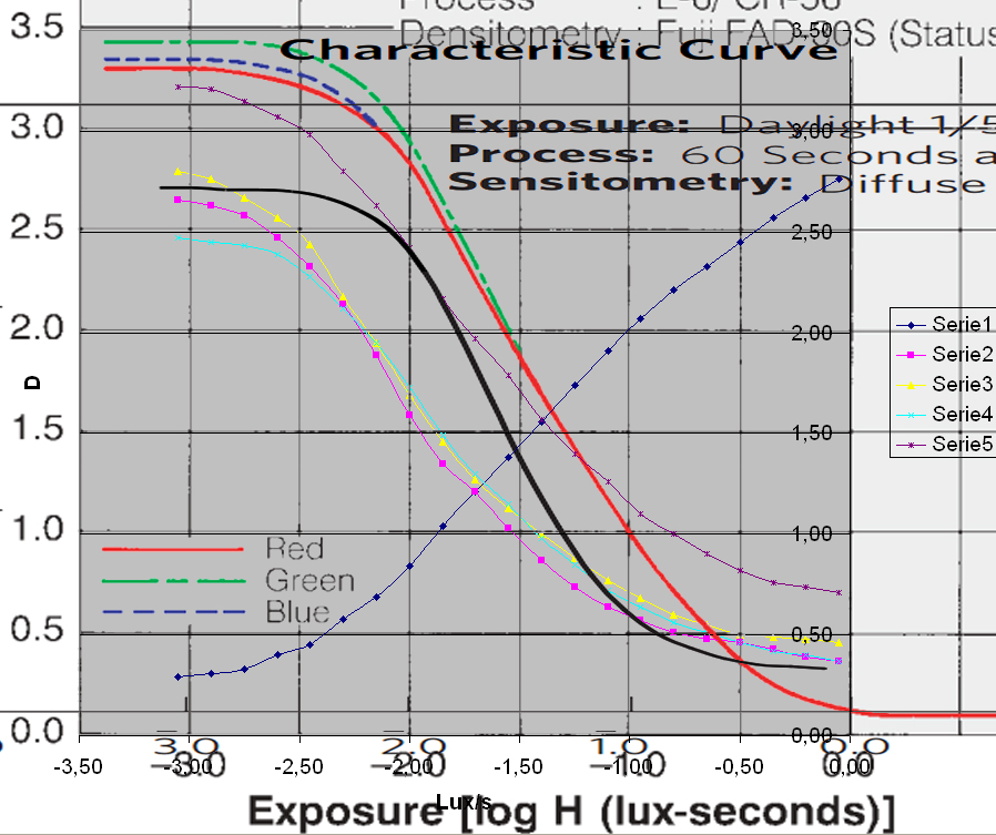

Yep, that would probably be better. That was just an idea I had for "develop by inspection" adjustment, and would require an experienced eye, like any DBI process.
A good way to calibrate R processing for a certain film is calibrating it with different settings, better with absolute H units, then with Photoshop we overlap the calibrated curves with those in Provia datasheet (or TX for cinematographers) , this allows to selec the settings for a suitable contrast and what speed we should use, relative to provia. This is the fastest way, when curve is correct it will work optimally in the first try, beyond fine aesthetic adjustments be may later make. I also delivers first class information about how to control processing to meet a cetain goal with precision.
If we are to scan then we can adjust many things in Ps, but for projection contrast has a really narrow margin compared to the one (for example) Provia has. In my experience H-D calibrations are way more useful for reversal than for negatives. It's about mastering what Beyond The Zone System book explains...

Ps is used to overlap graphs, not images of scenes !
This is a series of tests I made recently for a new processsing, compared with matching scales to Provia and TX, no one worked, but in the graph it is quantitatively displayed why: issues with DMin, DMax, and contrast are seen, so it shows me the path to obtain an optimal yield for the next time.
The curves show that I only have to increase contrast to match TX (in cinematography), but I have additional work to match Provia dynamyc range in the projection, which is my goal.
Also negative development curve is shown for a processing, which allows to see if development has to be more energetic.
An analytic approach can be useful when many factors are in play, for example when adding Se toning to increase DMax.
