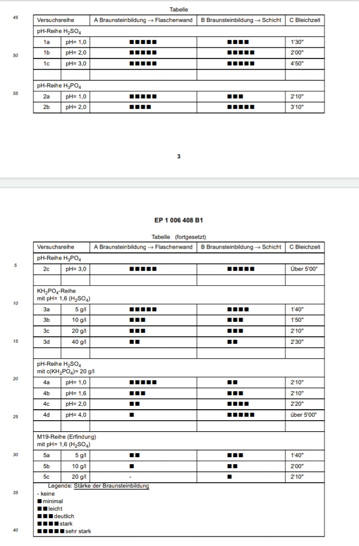

On the subject of permanganate bleach, I made an observation last night. I mixed the following bleach formula in deionised water:
20g sodium hexametaphosphate
1g potassium permanganate
50g sodium bisulfate
Top up to 1000ml
My previous formula was the same, except the omission of sodium hexametaphosphate and seems to bleach fully developed film leaders in a minute or so. My previous bleach would come out of the tank with a slightly different colour. Instead of the dark purple of permanganate, it would take a more reddish, perhaps slightly brown colour. This time, the bleach with 20g/l sodium hexametaphosphate came out exactly as it was, which I believe is a good sign.

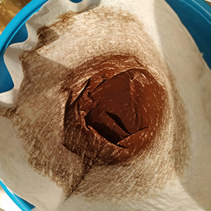

It's been almost 3 months since I made this post and I have some details to share. I processed 2 films with this bleach while it was still fairly fresh, the second was about 3 weeks after it was mixed. In both cases it performed very well and seemed fine after use. But then, life got in the way, I got too busy and haven't processed anything more, but occasionally had a look at the bleach bottle. It slowly formed a precipitate, which became pretty obvious around two months after being mixed. At about this point I filtered it through a coffee filter (see photo below for dry precipitate) and tried with a scrap film leader. Sadly, it was nowhere near as potent as it had been in the past. It didn't fully clear the film leader after 5', even at a temperature significantly higher than 20°C. So, I'm not very sure when this bleach became too weak to properly work, but perhaps some more testing can give an answer. But even if it died in a rather short time, it's not a total failure and I'll probably stick to this formula since I find it rather boring to mix it fresh every time.

Yes, the hexametaphosphate free formula is supposed to be one shot. Considering how it looks after use, I'd say it certainly is.
A minimum 3 weeks life at working strength for a solution that would be getting replenished if it was in day-to-day usage isn't bad at all - especially compared to the non-hexametaphosphate containing version. There is a comparison table in one of the Agfa patents (EP1006408B1) I cited earlier that shows the extent of manganese deposit formed on the bottle walls over 42 days in column A & the extent of manganese deposit formed as a result of the bleaching process in column B. I've appended a screenshot to this post that shows how severe the difference is - the German required to understand it is minimal.
