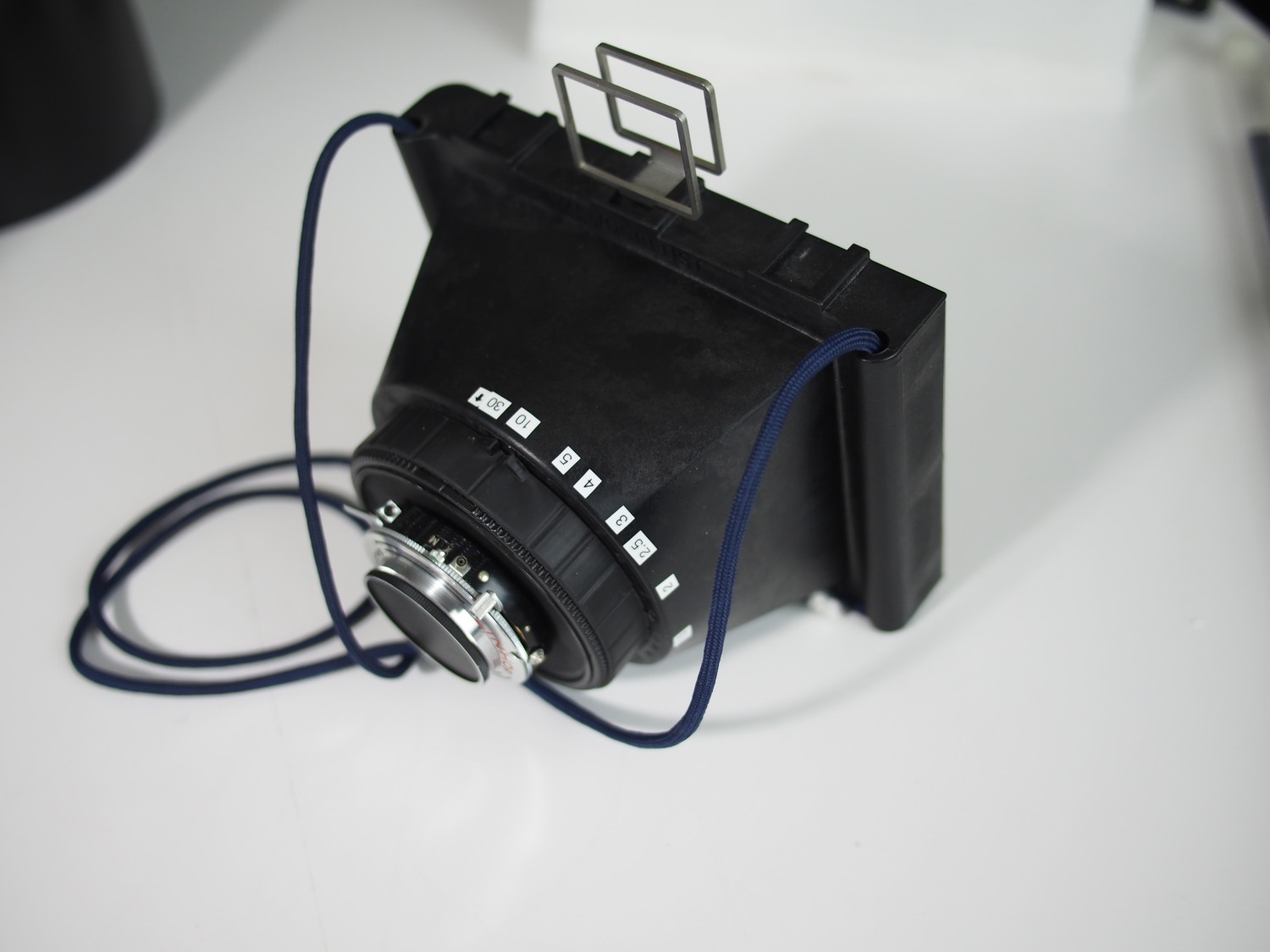

I bought a WanderLust Travelwide from an original backer several weeks ago. (It seems that in the two years it took to get it, she changed her mind about shooting large format film.)
Anyway, my thoughts:
Yeah, the lens is a bit tricky to mount but nothing to worry about.
It is very, very light: about a pound and a half, with the lens and a film holder. However, it still has a solid feel to it. Balances okay with the film holder installed.
The "ground glass" is useless.
The helical focus on mine is just about perfect. It's not Nikon smooth but works fine.
The viewfinder is, well, the best I can say is "functional".
I don't mind the distance markings in metric but they are impossibly small to read, especially since they're on the face of the lens mount. I printed out labels to add around the outside of the housing, note that I've turned them toward the photographer. Not pretty but they work. See the picture.
I also ran a length of parachute cord through the holes to form a neck strap.
While I don't normally use a lot of lens movements, I miss them when they're not available.
I tried adding some sample photos that I took but for some reason APUG won't let me add anymore pictures. You can see them on my facebook page: https://www.facebook.com/timothy.klein.338 You may have to scroll down to find them.
Of course, the biggest selling point is the weight. For example, I never would have lugged my Super Graphic (5.5 lbs), halfway around Estes Lake on a walk with my wife; in contrast, I hardly noticed the Travelwide hanging on my shoulder.
On the other hand, I was disappointed with the photo I took with the Travelwide from the Stanley Hotel lobby.One of the issues was that the light weight of the Travelwide fooled me into ignoring the need for a tripod. I could blame the camera but I should have taken the time to unpack the Super Graphic. However, I will blame the viewfinder for less than perfect composition.
(The photo we entered into the contest: http://stanleyhotel.stories.travel/Photo-Explorer?flipto=6PODp3-fb was taken with my digital, I hadn't gotten the film developed.) And yes, this is a cheesy attempt to rally votes.)
I've also taken some shots with a roll film back (I can hear some of you yelling 'heretic'!) I wedged a piece of dense foam under the left end to hold the adapter down tight (the spring clips did okay on the right side). Worked fine and actually balanced rather nicely.
Summary: I like it. For many photographers it will fill the need for a large format camera at a reasonable price. I can see it being especially attractive to pin-hole fans. It's also a cheap way to shoot 6x9 (or 6x6 or 6x7). It can't do everything a "real" field camera can do, but I can take it places that I wouldn't take the "real" camera. Like all tools, the real limitations are in the user.
time48v:
I see you apparently forego the cable release. Do you experience any issues by tripping the shutter manually?
I tried the cable release configuration. Of the three cable releases I have, only one was the right size to fit the hole. It works, but I find I'm always holding the camera with two hands anyway and tripping the shutter with my right hand is easy. Besides, I find the neck strap essential.
