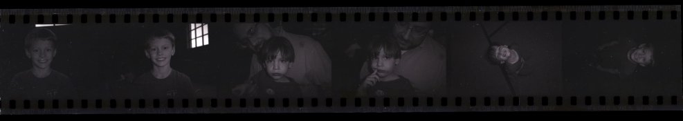

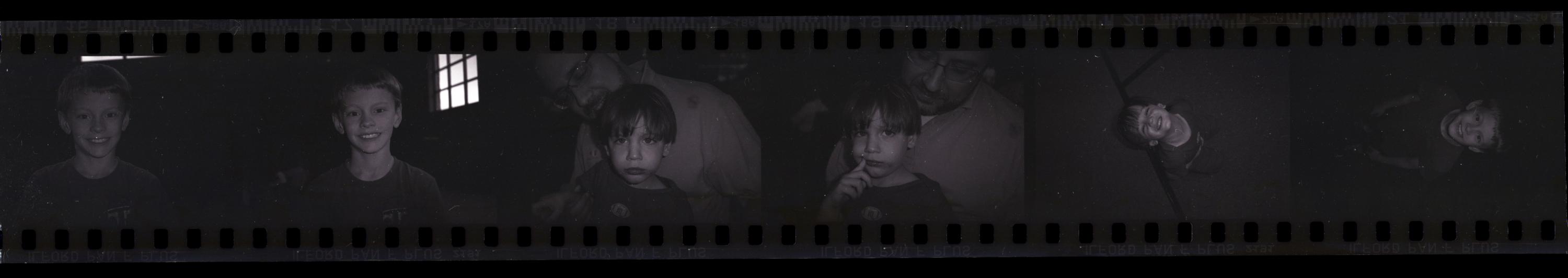

As promised...

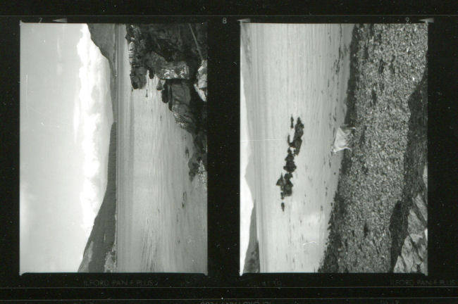

I can confirm really good contrast negatives and thin edge markings compared with say Delta. It worried me at first too, now I just ignore. One film edge markings were so faint as to be almost unreadable. Negs were fine.
From contacts on a dusty scanner......

Thanks again, everyone. I posted a sample of the negative above. Today I'm going to blow through a roll of Neopan 100 (120) and develop more or less identically so that I can decisively rule out the developer, containers/tanks, etc.
I wonder about heat. I took the camera with me to South Louisiana in July. I was careful, but I'm sure it did get some heat exposure. Never left it in the car overnight or anything like that, but still, I had it with me on some hot days.
The only other strange thing I can think of that I did with this film was to tape on a false leader. But I've always done that with this camera, as the T5 wastefully auto-advances past three or four frames.

Ruling out the developer and, pretty confidently, accidental contamination. I shot a roll of Neopan 100 today and developed in Perceptol 1+1 for 15 minutes; it came out beautifully. I used the same tank, reels and containers and didn't do anything with them beyond giving them a cursory rinse.

So, camera, operator, and film remains. What's next?
