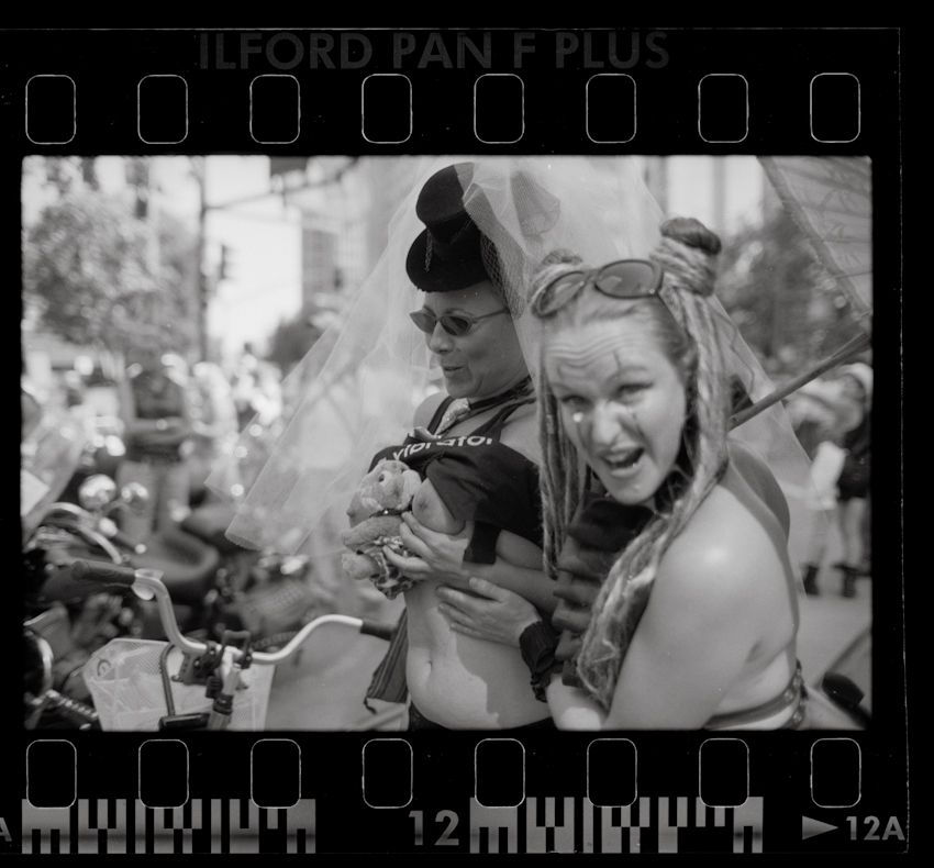

I don't know guys, I've always had slightly thin edge markings, but nothing ridiculous. In fact - I'd say this is a common characteristic of Ilford films in general. Here's a frame of PanF+ (I don't even know what the exp date was), developed 3-4 months after shot:
attachment.php
I'm sure you're all intently examining the edge markers as we speak, but they don't look too out of line to me.
