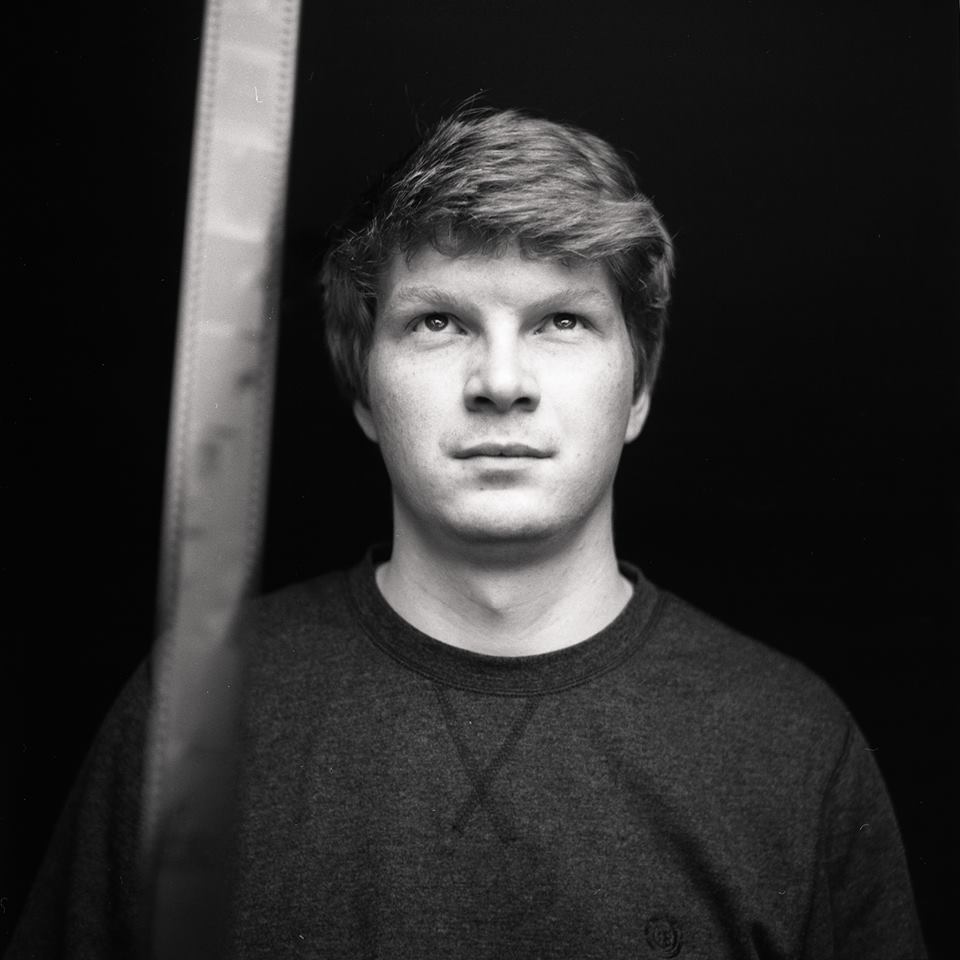

I've started a topic about this previously, but it really gets worse and worse. I've been developing my own b/w negs over 2 years now. Always shot on Tri-x, no problem.
Since I'm starting to print more seriously, I've noticed that I always have to grab for higher grades. I started with a M305 Durst, then M605 and now a M670.... And it feels like the M670 doesn't produce as contrasty prints, so I have to reach for higher grades, but then negatives that I know that have full tonal ranges, print well on grade 1-2.
I mostly worked indoor, window light, bright portraits, and the background fading in darkness, so mostly good tonal range and still ... I always develop 20 degrees celcius, follow the dilutions / times from Massive Dev Chart.. and still they look so flat. Normally the negatives look good (checking by eye) and lately I found that my negs really looked flat/dull and I can't seem to find why.
This is very strange... any ideas? It's a fresh bottle of HC-110, always dilution B, always same agitation...

I checked. Developed a FP4+ roll today, 8m45seconds, manufacturer says 9mins... And these look VERY flat, even on scanner. Reading them with a real densitometer tells me that they are very flat. Even though it was quite sunny today and had a good amount of tones... Should have brought my spotmeter to check...
I hope it's just because a lack of tonal range in real life and nothing to do with my development

Mhm. No, it's the new bottle. Same as my previous bottle. I already increased my agitation, as I always agitated very very slowly. So I went two two full agitations, every minute within 10 seconds...
I'm a person that likes a little extra contrast anyways, but right now , it's just "dull"

To all, many thanks for the comments. I have been metering and checking negatives with a densitometer and it seems like it's just the "light", as I have some well exposed negatives with plenty of contrast on the same roll as very dull negatives. Any tips for developing 135/120 when it's a duller day or should I change exposure? Too bad you can't expose for the shadows and develop for the highlights on rollfilm...

I've been thinking about it, but then I ask myself, why do I have to change my development from the recommended times?
I'll shoot some new rolls and check with the spotmeter for the zone system, see if there is plenty of tonal contrast and print those negs. If it's still flat, then it's probably my development

I used to meter with a spotmeter ( Pentax Digital Spotmeter ) but went back to a Minolta IVf because I felt my exposures weren't consistent enough and mostly a bit overexposed. The meter matches with my Sony A7 meter, and my other in camera meters. So the meter is not the problem.

Ha! I said that to a friend, maybe it's just the light of the winter... but was not so sure. As I really have some well exposed negs lying around, but I find it very difficult (and that's why I like shoothing b/w) to find a very good tonal range scene. I feel that my highlights and mid tones are mostly ok, but lack of shadows/blacks when I'm shooting outside. When I'm shoothing inside, I get more contrasty negatives for sure, unless I have these small windows and shoothing far away from the light source, then everything seems ... flat.
Is there any way, to compensate for flat light outside? Maybe even a faster exposure, so I get more shadows and compensate for the highlights in print exposure?
Checklist:
- Fresh developer, both film and paper
- Fresh paper
- Fresh fixer (not underfixed, clear negative base)
- Meter's are okay
- Shutters are okay too (different camera's) and some had a CLA recently

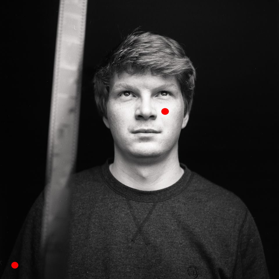

I have checked some negatives with my RH Designs Analyzer, read out the negs with the densitometer. I can safely say that, my negs are semi-ok. I have compared them to very contrasty negs and lower contrasty negs, to find out how they compare to each other. So, the analyzer is calibrated for different papers. Currently I'm using Adox MCC and when I'm reading the highlights/shadows on that paper I have to go for a much higher grade. If I use the factory defaults (multigrade filters) - not the color filters. I go from ex. Grade 4.5 to grade 3.... I will recalibrate the contrast settings for the analyzer and check if I made any errors.
Means => enlarger is probably much less contrasty then the average filter. So a dull/flat negative becomes even duller..
Edit: I have rechecked my contrast calibration and seems much better now for most negatives, still have to add a grade or grade and a half to get full tonal range, but on very contrasty negs I have to go to grade 1. But that's for the negatives before I started noticing flatter negs...

- And especially (see attachment), this was a test portrait to see the exposure problems, (it's an editted scan). I placed a friend in front of a window, having so much exposure on the face that the background fades away because there is more then 7 stops of separation between highlight and shadow.... BUT if I check with my densitometer.... it's quite contrastless (no real white highlights)... because the brightest part is the skintone... so zone 6...
(The contrasty negative is between 150-300, so a difference of 150 on the densitometer.. and the grade 3-4 negatives are more like 230-300 ... a difference of 70.. or sometimes even as low as 50)

It has never been clear to me what you regard as a flat print. Do you regard the jens portraits as flat?
Show us some flat negatives and what prints from those negatives look like at grades 2,3, 4 and 5 look like
We will be in a better position to advise you what to do once we see a range of examples
