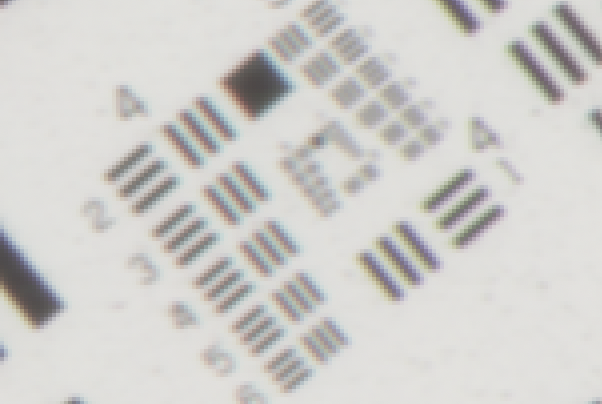

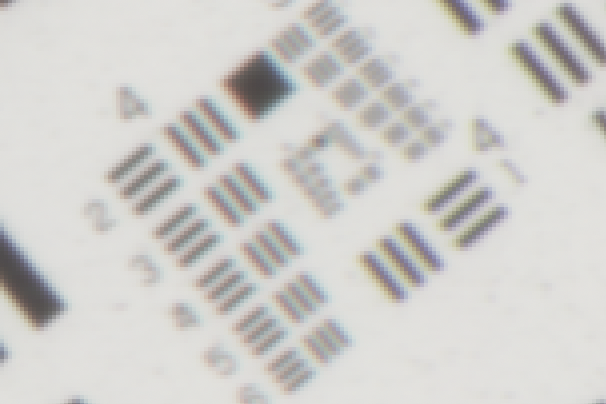

I have addressed "1.200dpi" claim in that article.
If you see difference between your 2.400dpi and 3.200dpi scans that is unfortunately NO proof that you are resolving more than 2.400dpi.
400% of 2.400dpi scan
400% of 4.800dpi scan downsized to 2.400dpi
4.800dpi resolves more than 2.400dpi scan. Neither is close to real 2.400dpi.
Can you post the 4,800 dpi at 4,800 dpi? Because it seems to follow that if you reduce the resolution of the file, the resolution will decrease.
Besides that here’s another problem with the test target. You’re calling a difference where I see none. It’s somewhat subjective

Well, then we need to make it less subjective. Download both files (original 2.400dpi and 4.800 downsampled to 2.400dpi). Compare the file sizes of both files, bigger file is the one with more detail.
Why are you down sampling the 4800 to 2400? That's like comparing 0-60 times between a straight 4 and a straight 6, but making it "fair" by taking out two spark plugs.
You've made your results entirely dependent on the quality of the down sampling algorithm.

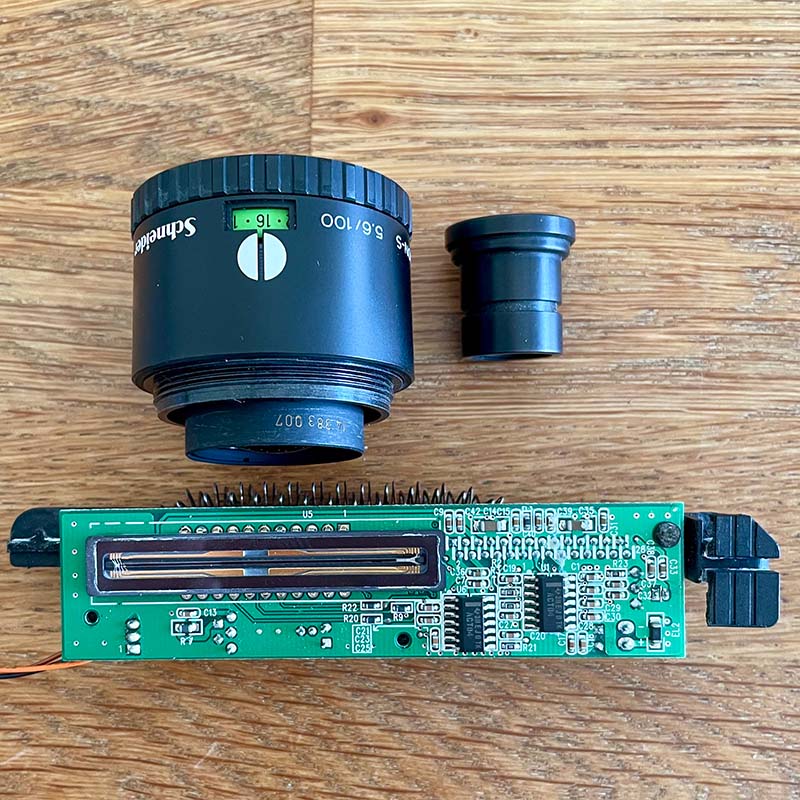

Now imagine arguing about scanners with a LF shooter (averse to using a material that will have detail beyond 100 lpmm - like a resolution target). "My V700 scans of 8x10 film have every bit as much detail as a drum or hi-end flatbed scan, ergo V700 is as good as any scanner out there". I never measured what I can get out of my admittedly pedestrian LF kit, but I'd probably have to have pretty much all the planets aligned to get more than 40 lp/mm, so, yes, for LF anything that will give you 2.000dpi will most probably be good enough (not for the "look at that pretty grain" guys, though).
For illustration, the typical consumer flatbed CCD sensor and lens (taken out of Canon 9000f scanner - if I'm not mistaken I've measured that scanner at about 1.600dpi with supplied holder); Schneider Componon-S 5.6/100 enlarging lens included for size comparison:
Compare that to a lens (on the far right side) from a hi-end Scitex Eversmart flatbed. Eversmart uses stitching so that lens needs to cover only a fraction of the area that the button-sized consumer flatbed lens needs to cover.
