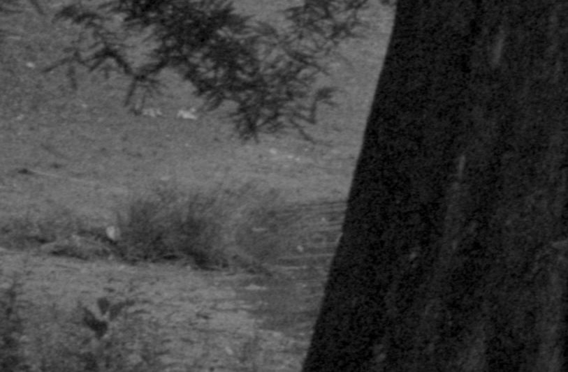

First I will present a 100% zoom of a 6,400 dpi scan of a piece of HP5. This is the highest possible resolution of the scanner.
As you can see we're resolving beyond the grain of the film. We can see the film grain and it is not only present, but it is definite beyond the mere absence or presence of each individual grain (i.e. beyond the pixel level.) I have intentionally left the bed of the scanner dusty in these tests so that you can see the resolution of the scanner as it relates to not only the finite resolution of the image in the negative, but also the infinite resolution of the physical dust.

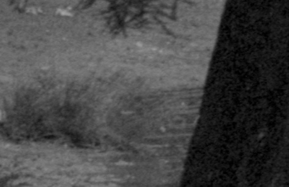

Here now is a 400% zoom showing that the grain is not only present as the presence or absence of each grain, but that the scanner is resolving beyond the grain to show the contours of each grain, resolution beyond the information that the film contains.
I don't see it.
I suspect your understanding of what grain is in relation to silver particles is not entirely sufficient to make the interpretation you think you're making.
mush. It's showing mush.

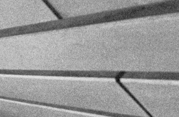

I've scanned quite a bit of HP5+, as well as other kinds of film, on a scanner that evidently outresolve yours as well as a flatbed that's in the same ballpark. What you've shown in your example is a relatively low optical resolution interpolated image to fit a certain dpi resolution. I can tell you that if you scan at a higher resolution, you'll notice the grain takes on a sharper and better defined look. The results you posted are pretty much on par with a scanner that resolves in the 1000dpi-1500dpi range.
Here's an example of HP5+ scanned at 3200 on a scanner with an optical resolution that's around 3000dpi (according to the people you don't trust):
This is scanned without further processing such as sharpening. Note that the grain (same film as yours!!) is quite well-defined and looks, well, sharp. If you were right in saying that your 6400dpi scan has already outresolved the film, then the above scan simply couldn't exist. Alright, my scan is 3200 dpi, yours is 6400, so you're skeptical. Let's do a little experiment.
I could upsample my scan to 6400dpi so you can compare it with your scan, to which end I took a randomly selected small sample of your scan so you can see the difference:
It's the same digital resolution (6400 dpi) which you can easily see is a pretty meaningless piece of information; you can upsample any low-res image to insane levels by whatever interpolation mechanism you prefer, or apply oversampling if you're fancy, but this doesn't restore image information that wasn't scanned in the first place. On the left, there was a little more information to begin with, so the upsampled image doesn't look as mushy as the one on the right, which evidently didn't have much image information to begin with.
You could approximate the optical resolution of your scanner by downsampling your scan to the point where things start to look like they're actually in focus. This starts to happen around the point where you reduce your scan in size to about 25% of the original. That translates to around 6400/4 = 1600dpi. Interestingly, that's pretty close to what some people who take the time to test this properly try to make you believe.

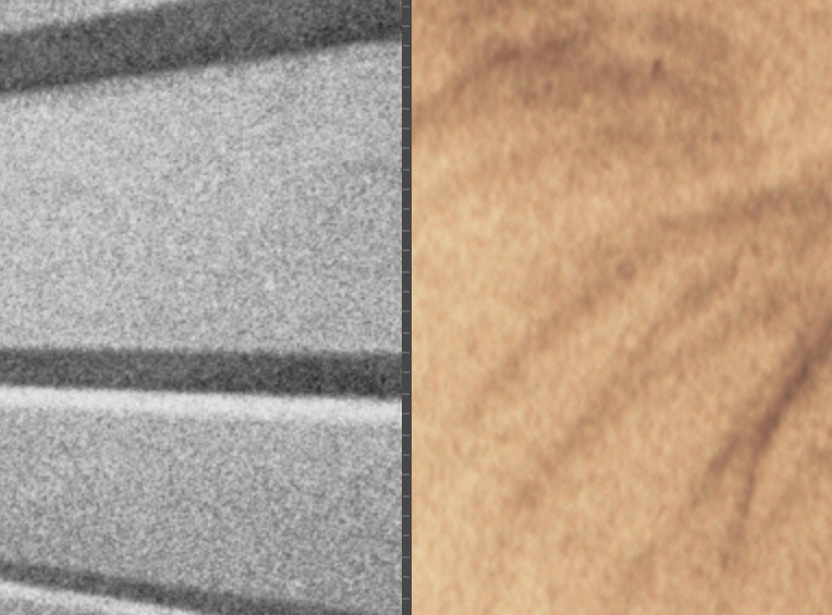

Alright, for shits & giggles, here's a flatbed scan from a scanner that's in the same league as yours. It's a little older, but in terms of optical resolution, it's somewhere in the same ballpark.
This is again HP5+, I think developed in Rodinal, and scanned at 3200dpi. Here's the same thing (well, a crop) upsampled to 6400dpi:
We're now looking at the same sort of mushy image as your original scan. You could brush it up a little by adjusting contrast and applying some sharpening; I did neither and just lazily cropped part of the jpg scan as I had it on my harddrive somewhere.
If I play with this a little, I can determine that the actual optical resolution of this flatbed scan would be somewhere around 1600dpi, pretty much like yours. That's again consistent with the German guys who rated the scanner I use at around 1800dpi if memory serves.
Now, you can always be overly optimistic and argue that the pixels you're seeing are all meaningful, but that doesn't necessarily have any bearing on the real world.
