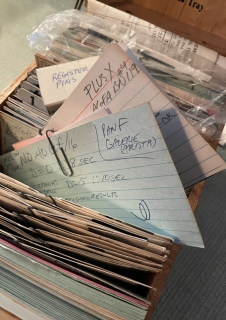

I found my register pins.
Is it ironic, or foreshadowing? I found them in the old card file where I keep pieces of paper to use under the grain focuser.
