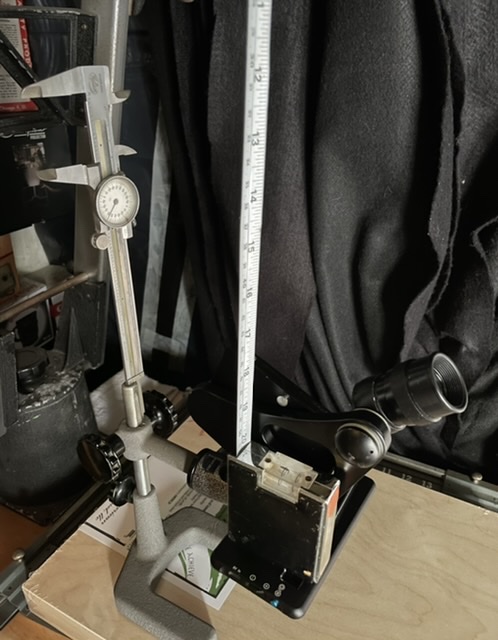

In that thread I did a different test and estimated a tenth of an inch range of sharpness at f/5.6 viewing through the grain focuser. But my butterfly test showed that on prints, the estimated range of sharpness is a quarter inch at f/2.8 which is more I think because you cannot see the grain.
A test I did today, mounting an SLR with no lens on a microscope stage and racking it up and down looking through a reflex magnifying viewer, also comes in near a quarter inch at f/2.8
The next test I do will span a half inch, I don’t think I will use single weight paper but am entertaining the idea “because I can”. It will take a sharper negative with fine detail. I have some ideas of what negatives might work.
Another check using the grain focuser on a microscope stage. I racked the focuser up and down then came to the best focus 10 times, calipering the stage height after each best focus.
The results varied, as expected. The standard deviation was 0.076 - inch.
Average missed the original mark by 0.07 inches - about 1 standard deviation low.
Error of 0.07", far greater than one thickness of double weight paper at 0.015"

Bill, you used a focuser that is 10x, I used a 25x model. Do you feel the greater magnification may reduce the margin for error any?
Greg, I think absolutely you will have better repeatability and precision with 25x vs my 10x.
Give it a shot, even if you don’t have calipers you probably still are going to miss repeatability by a sixteenth of an inch.
25x is good for your way of working. Since I work the other way I don’t normally try to move the easel into focus. I have to Jerry rig to focus at the easel. My normal steps are to locate the negative a fixed distance from the easel (22 3/16 inch for 11 x 14) then I focus the lens. For this, my 10x is sufficient and quick.
The next part is an order of magnitude less precise. The results, when you can tell the difference in an 11x14 silver gelatin print from 35mm negative. My last test spanning a quarter inch didn’t find the range. I think it is the range but with nothing outside the range I couldn’t tell.
So I am going to try more like 50 sheets. I will try a different negative too because my butterfly is a little unsharp.

Bill appears to have convincingly determined, "It does not matter to have paper under focuser", and with 10X focuser there is 0.076" typical error that is often not detected even at f/2.8 The only remaining question is "if using 25X grain focuser, is the margin of detectability reduced?"
The methology of test would merely entail someone with an enlarger and using 25X grain focuser, and doing 50 trials of repositioning enlarger to identical elevation using the grain focuser, and putting 50 marks on the enlarger column, for each attempt to bring enlarger back to position. No paper need to be exposed.
