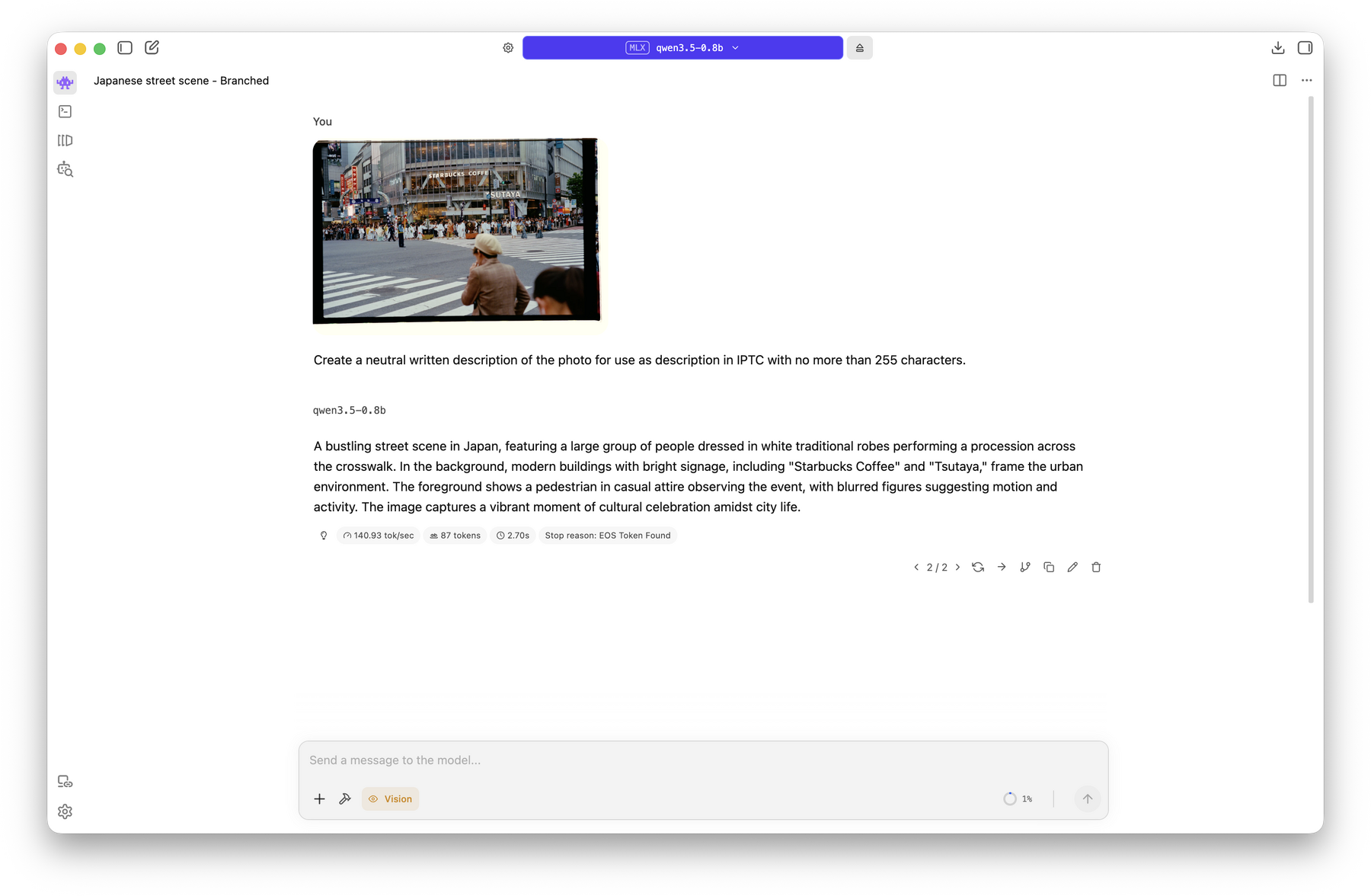

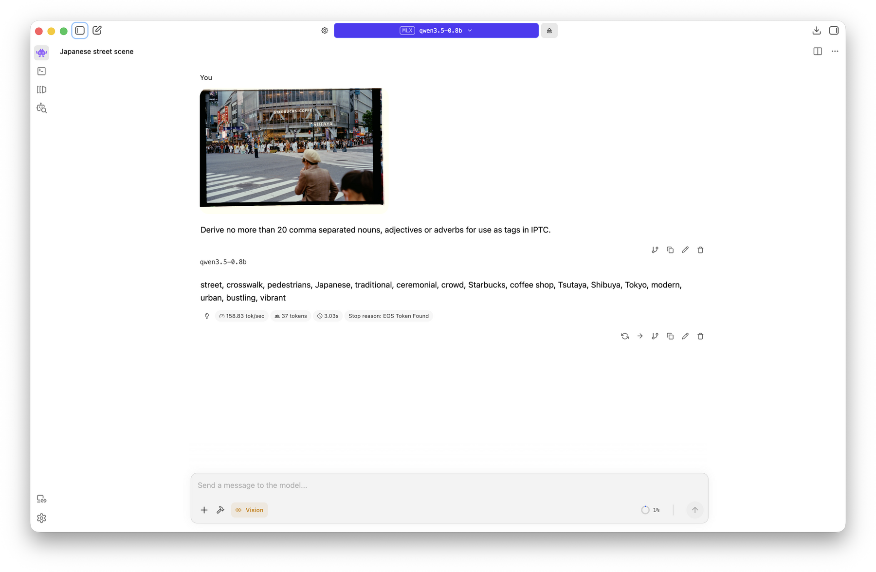

If talking local LLMs - I find them very powerful for tedious tasks like IPTC description and tagging. As I'm currently writing an application I would be interested in how others are thinking about this. I always wanted to manually tag my images but then failed miserably in doing exactly that. Now with local AI that's actually so easy to implement that it's worth a try I would argue.

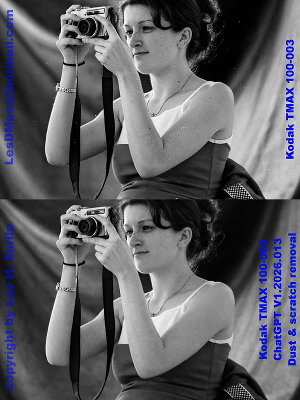

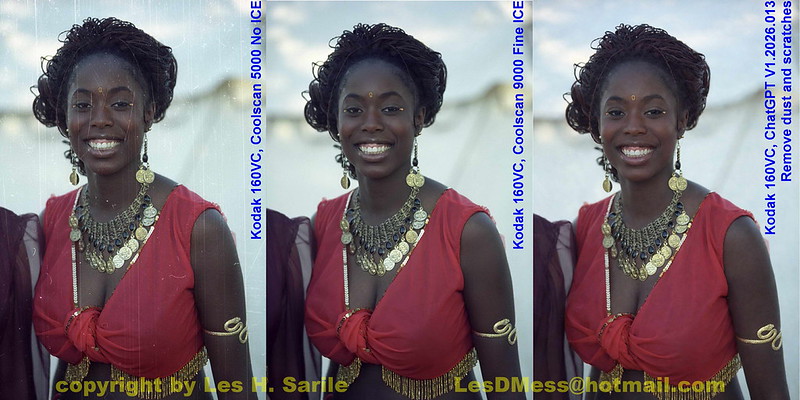

A colleague was just showing me his latest results from ChatGPT so I thought I would try removing dust and scratches compared to my Coolscan.
Kodak 160VC-06-36 9K ICE vs ChatGPT by Les DMess, on Flickr
With a ChatGPT subscription, the processing time takes about less than a minute compared to additional 30-40 seconds to the scan with ICE enabled.
However, Coolscan's ICE does not work with true b&w films so that can save in post processing for those types of films as shown below. Granted my b&w sample is not as badly scratched but the results look good. I always hated spotting my prints . . . :tongue:
Kodak TMAX 100-003 ChatGPT D&S removal by Les DMess, on Flickr

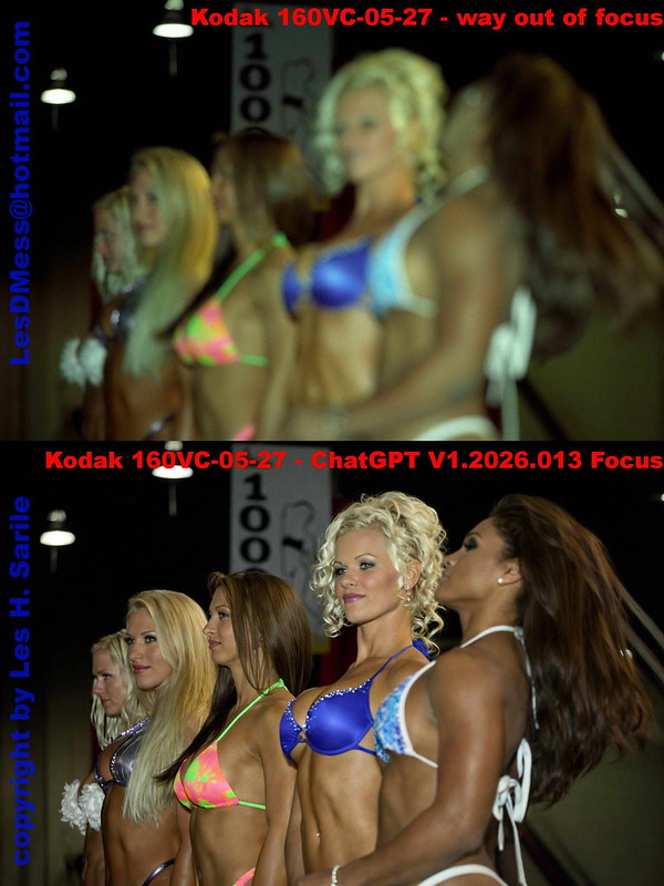

While playing with this, I thought I would try to see if ChatGPT can also do something with badly focused or blurred images. Over the years, I've tried to do something with these types of images with less then optimal results. A year or two ago new AI tools started coming up promising to focus images but those that I've tried didn't produce any results I would even consider useful. To my surprise it looks like we now have a tool that can address this!
This was a badly focused image I took on Kodak 160VC many years ago and ChatGPT handles it very well I think.
Kodak 160VC-05-27 ChatGPT Focus by Les DMess, on Flickr
It goes without saying that with images this bad, ChatGPT is making "guesses" at what the image should be - filling in details. I have other clearly focused images of these contestants and the guesses were reasonably close. So, if the guesses close enough then great and if not then not so great. The pixel limit still applies here too.

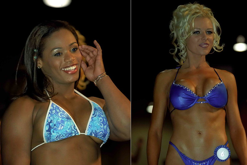

Here are other pics of two that you can judge for yourself what I considered a reasonable guess . . .
Kodak 160VC-05-27 ChatGPT Focus different angle by Les DMess, on Flickr
I think it's very interesting @Les Sarile and thanks for posting those! Apart from the observation I agree with that with the out-of-focus shot, evidently ChatGPT makes up most of the facial features, so I suppose this doesn't work too well if you know the ladies in the photo, as they may look odd or even downright 'wrong'. But the image looks plausible, that's for sure.
The dust & scratch removal exercise is interesting since it is evidently very effective indeed, but it also involves a subtle change in color (slightly warmer) and contrast (shadows lifted slightly). The result I think is pleasing, but not exactly true to the original. Then again, I also don't see (at least at a glance) very obvious signs of hallucination as we so often see in AI-processed images.

One thing. The black woman's face isn't even in the original. How can the AI photo show someone who actaully looks like the actual woman un;ess AI had access to her in another picture. Is it possible the image of her was in another photo that was used online by AI to assemble your picture?
No, it's just a hallucination. It's not a real person's face, but an amalgamation of faces from many many images upon which the software was trained.
Actually that's true for all the faces in the photo, none of the faces are the actual faces of the people originally in the scene.
Generative AI is not capable of making the kinds of decisions you're attributing to it. It doesn't have the capability to know who a person is, or what they look like. It's just predicting what it thinks you want the individual pixel values to be based on the pixel values it was trained on and the prompting you give it.
