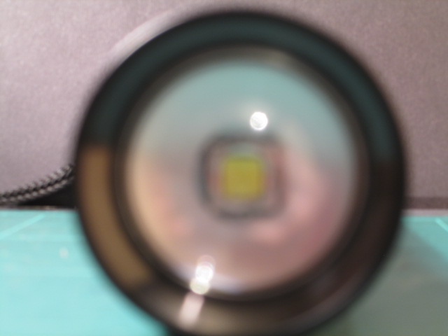

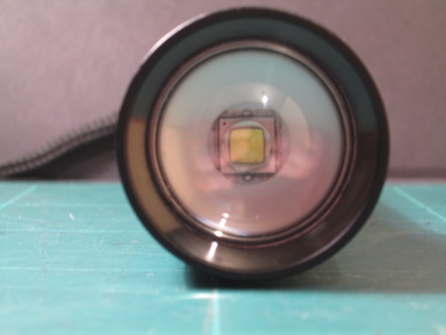

Do you use a torch with one of those powerful square LEDs?
The circle with a square in the middle reminds me of my LED torch.
Pictures below in focus and out of focus.
It seems the most logical explanation so far, I was thinking 'maybe a torch' all along but your photo makes it look very likely given the pattern.

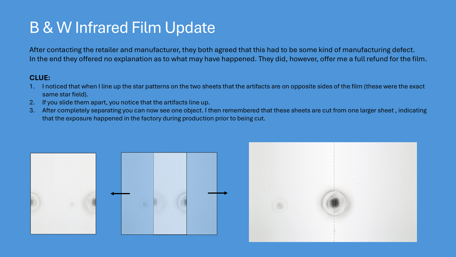

Been a while since I posted to my original comments but I have just had a breakthrough which lends a LOT of information as to where this might have happened.
1. As for all the ideas that I used an LED torch, or similar, that would have created a blank unexposed area on the outside edge of the film where it rides beneath the film ridges which hold it flat. The film is exposed all the way to the edge, so that rules out exposures in the film holders.
2. I made the assumption that since all the artifacts are in the same area on the one side of the film that these must have been exposed while stacked inside the film box. They all lined up so it made sense. Of course that would assume that whatever caused the artifacts had to penetrate 3 layers of cardboard, a plastic bag and a foil pouch, not really likely. This entire assumption was wrong (it could have easily been avoided if there had been film notches present).
3. ALL of these exposures were made of the Orion Nebula without moving the camera between exposures. These were clock driven images locked onto the exact same area of the sky. What finally caught my attention were the star images burned into the film. I noticed that when I stacked the negatives on top of each other with the artifacts all on the one side, the star images did NOT line up. I re-arranged the film so that all the star points lined up when placed on the light table. That is when I noticed that the artifacts were actually on BOTH sides of the film and not just the one side. I had an idea to pull the sheets of film apart so that the edge of film with the artifacts would be in the center, and that is when it hit me. The two images lined up to make a SINGLE image. And it looks just like the smaller artifact that was in the center of the film, just bigger and with more exposure. These 4x5 sheets are cut from a larger sheet and they had been sliced right through the center of the artifact, resulting in two sheets of film with an artifact on opposite sides of the sheet. That means that the film had been exposed PRIOR to being cut at the production plant. After contacting Rollei with this new information they reluctantly agreed that this had happened on their watch. They are sending me 2 replacement packages through the mail.
Hopefully I have illustrated my point in the image below.
I never would have guessed fogged at the factory. Good work figuring that out!

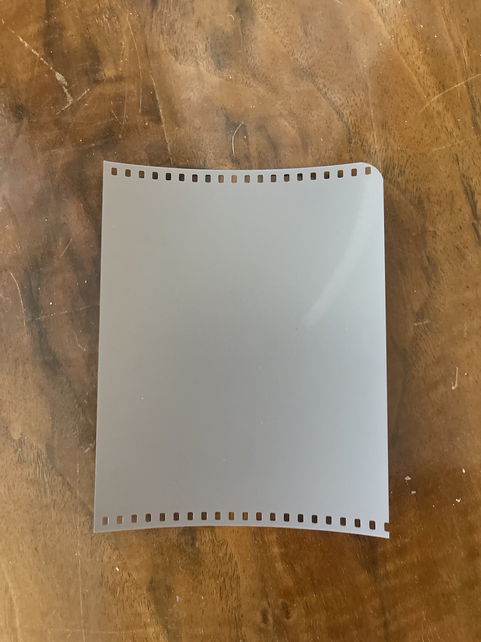

wait, I just read that this film doesn’t have a corner notch?! That’s actually wild. I thought about just telling people that the emulsion is just on the inside of the natural curl of the film, but that seemed like a disaster waiting to happen. So I spent like $75 on a corner punch so I can do a full stack of 25 sheets at once.
Scrap sheet of Aviphot 200 I had laying around:
