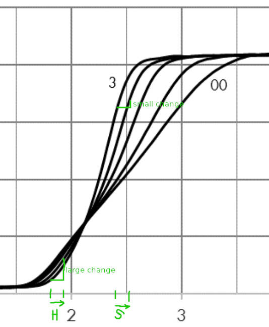

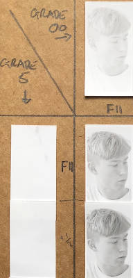

Actually, I'm not the OP, but because my question was similar, I revived this thread. Here's a crop from the OP's question:
Notice that the two grade-5 exposures seen in the left column have *no* tone; the paper is white. Yet they darkened the grade-00 exposures in the right column. What's going on here?
After much pondering, I finally figured out how to figure out split-grade by using the characteristic curves supplied by the paper vendor. Here's an annotated crop for Ilford's latest RC paper:
This example is for burning green. Adding green exposure shifts the entire image rightward on the X-axis. Above, I've shown the shifts for highlights (H) and shadows (S) on the X-axis. On the left (highlights), the new curve is *above* the old curve, causing a large darkening of highlights. On the right (shadows), the opposite happens. The new curve is *below* the old, causing little change in shadows.
For the example crop from the OP, adding blue shifted the 00-image rightward, darkening it. It's irrelevant that blue-only was below the threshold.
I finally understand not only *what* split-grade dodging/burning do, but also *why*. Unless I'm wrong about all this. I'm open to correction...
Simple. Grades 4 & 5 filters require 1-1/2 to twice the exposure than the softer grades. From the data sheet:
"‘Guide’ exposure times for filters 00–31/2 are generally the same; but filters 4–5 will need additional exposure times – typically between x1.5 to double the time."

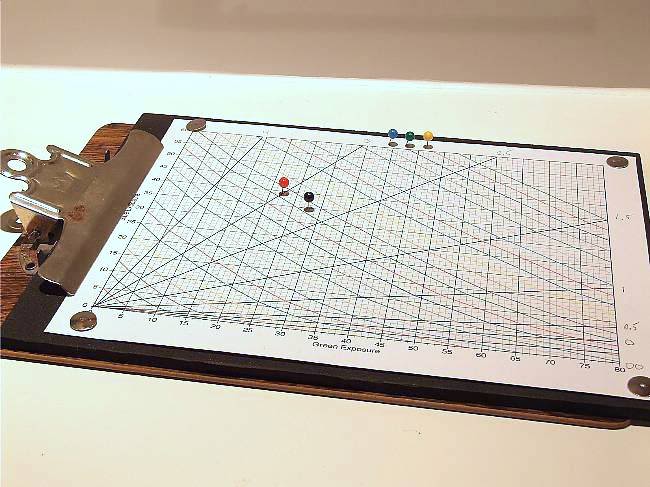

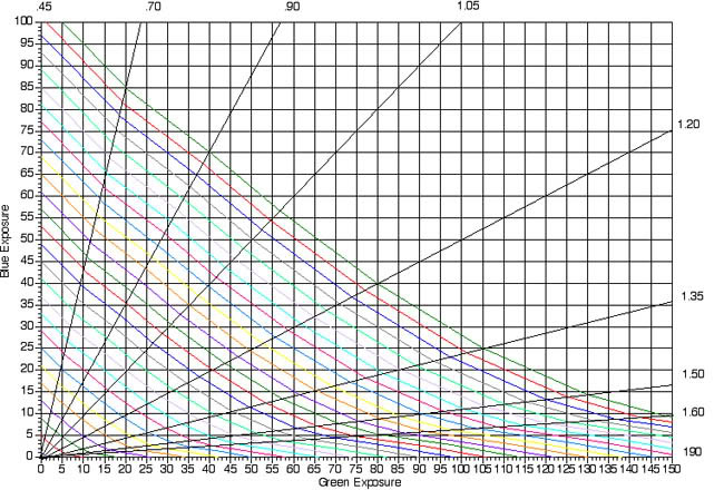

These are the tables I made for split grade printing. Radial lines are same-contrast (ISO-R from 45 to 190) and tangental lines are same-density. Push pins keep track of the sequence leading to the perfect print, allowing back-tracking, if needed.
albada
Apr 10, 2008
2,175
Escondido, C
View attachment 313747View attachment 313748
This graph is clever. I spent 30 minutes studying it, and mentally picturing how it would be used to change grade without changing density. Nice.
A few questions:
What paper is this for?​
What density did you use for the measurements?​
After obtaining one equi-density set of points (i.e., one colored line), did you scale them to produce the other colored lines?​
Again, this graph is helpful. You might want to post instructions on how to use it, because I suspect that many people will be overwhelmed by the many lines and immediately give up.
