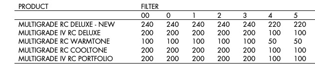

MGRC V still requires more exposure for the higher contrast filters. In fact all the Ilford RC (and I would think others) MG papers require more exposure for the 4&5 filters. Here is the Ilford paper speed chart:

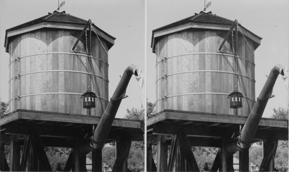

I've recently been learning about the uses of split-grade burning/dodging using green and blue (filter-00 and filter-5, respectively). I created the following table of all four combinations of burn/dodge and green/blue, showing what each is useful for.
Any comments on the table? Any more uses of these that I missed?
dodge green Boosts shadow contrast (but lightens adjacent light tones).
dodge blue Lightens shadows with little effect on adjacent highlights (but reduces shadow contrast).
burn green Darkens highlights with little effect on adjacent shadows (but reduces highlight contrast).
burn blue Boosts highlight contrast, such as clouds (but darkens adjacent dark tones).

Green(00) and blue(5) not only determine tone, but also contrast, which confuses things for me. That's why I created the table of all four possible dodges and burns. It tells me what those dodges/burns can do for me. For example, below is a straight print (left) and dodged print (right) that I made a few days ago:
I dodged the green exposure for 8 out of 16 seconds below the platform. The table says doing so will boost shadow-contrast, and it did. The table also says light tones will be lightened, and you can see that the foliage below the platform is lighter. I wanted the understructure of the platform to be more visible, and this dodge worked.
I have little experience with split-grade, so I'm wondering what else can be done with split burns/dodges. Hence the table and my question to everyone, which is:
What other good things can split-grade burns/dodges do?
