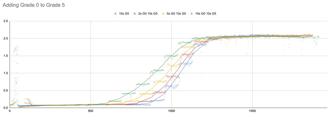

I started by bracketing "all" the mixtures of Grade 0 and Grade 5 since I wanted to see if there was a difference between split grade vs an intermediate grade.
Here's starting with Grade 5, then progressively adding more Grade 0 on top for each print (Blue is the start)

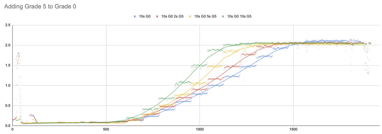

Here's the opposite, starting with Grade 0 then adding more and more Grade 5 on top this time

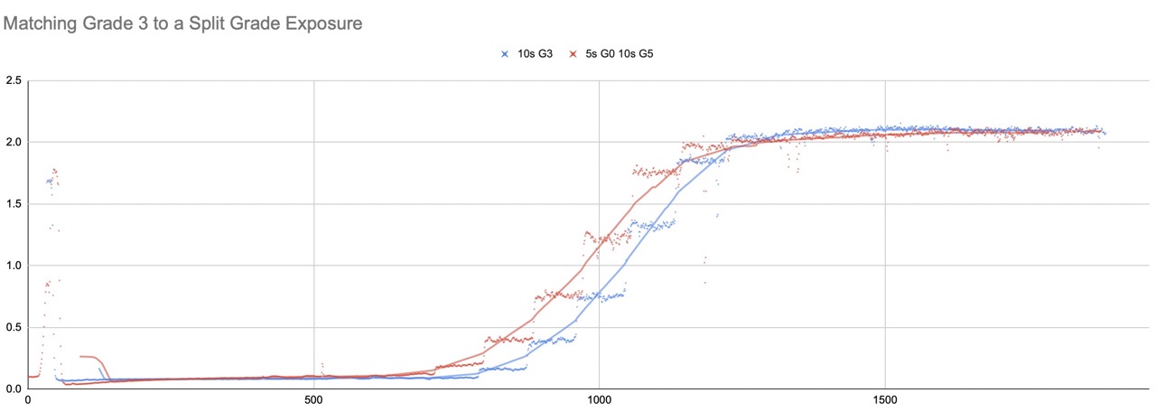

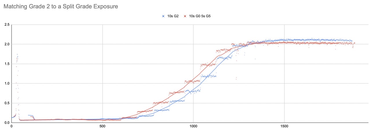

Then I printed each grade on its own and tried to pick one of the lines from above to see if there was a match
Grade 1
Grade 2
Grade 3

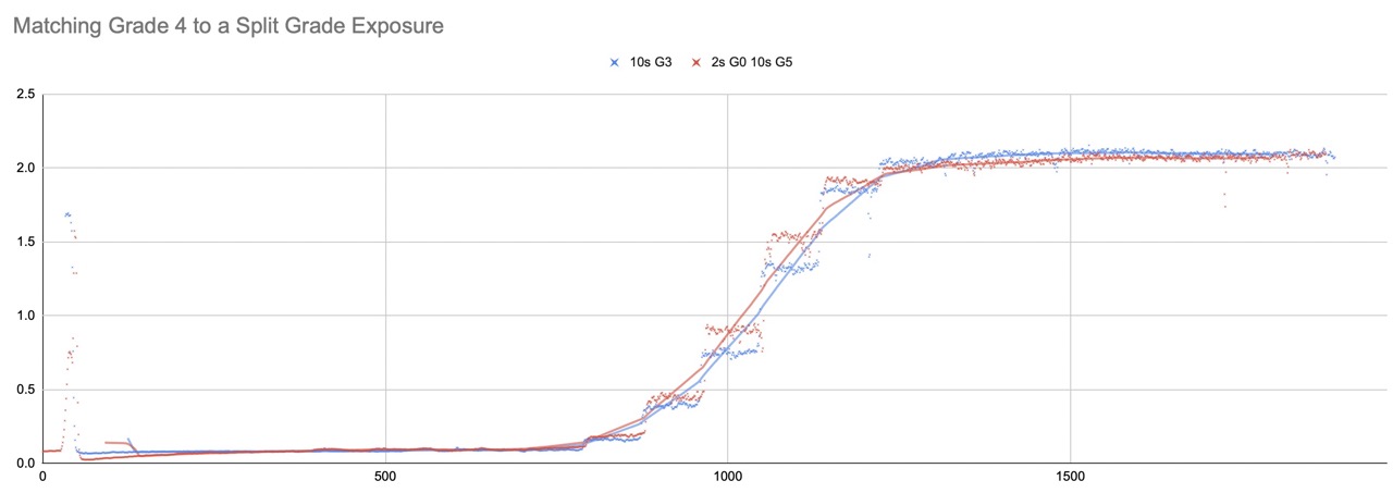

This may be obvious to other folks but I was short of surprised to see that there was no difference between split grade or intermediate filters, at least for the base exposure (dodging/burning is a different story).
Note that I'm using a Beseler 23Ciii with a variable contrast head, not sure if this would be somehow different with individual filters.

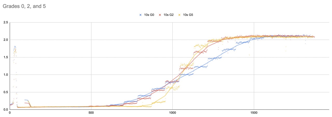

Also I thought this was really interesting, look how the grade 2 print rides on top of the grade 0 curve then as grade 5 crosses, it switches over and rides on top of that. It's kind of like your green sensitive emulsion is in control of the highlights and the blue sensitive is in control of the shadows. Seems to me like this isn't ideal since your contrast index is always going to have this curve to it. Not sure if the classic graded papers had this characteristic but seems to me like potential reason someone might prefer them. At least if that had more linear responses for each grade

Thanks for posting those graphs. I made similar measurements to use inside my DIY LED-head controller. It can compute green and blue exposure (i.e., 00 and 5) based on only one test-strip. To do that, I had to put curves like yours inside the controller's memory for the type of paper in use. That exercise helps us to understand the paper. Your observation of green controlling highlights is both perceptive and accurate.
snusmumriken
Jul 22, 2021
2,363
Salisbury, UK
Would this still be true if you were using yellow through magenta filters? I don't think you mentioned which paper you used here, but officially the difference between the three emulsion layers in Ilford MG is indeed how sensitive they are to green light; they are all sensitive to blue (source here). Yet the filters for Ilford MG are yellow-ish through to magenta-ish. Why?
(Strange that in the source linked above, the 3 under-lens filters pictured are all the same colour!)
Cost was (is?) typically the reason for sticking to fixed-grade papers with a single emulsion. However, you could end up with boxes of rarely-used brands/grades/warmth/surface that had passed their best-by date, so for low-output photographers like me it was a false economy.
Thanks for posting these graphs. Although the underlying facts are familiar, it's still interesting to see. I presume the units are milliseconds on the horizontal axis? How have you measured density?
