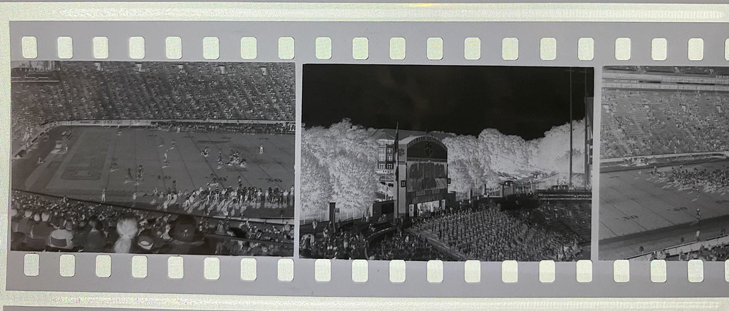

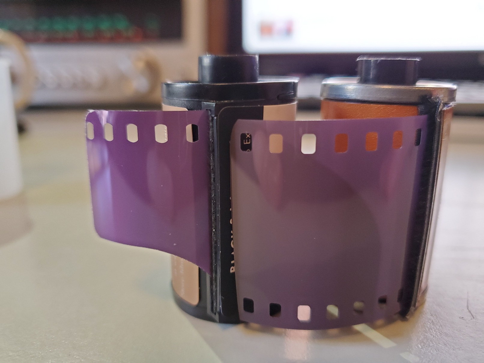

I believe film stocks intended for motion picture or lab use often have perforations with more rounded edges than stocks intended for still camera use.
On the left is Orwo DP31, and TMax 100 on the right.

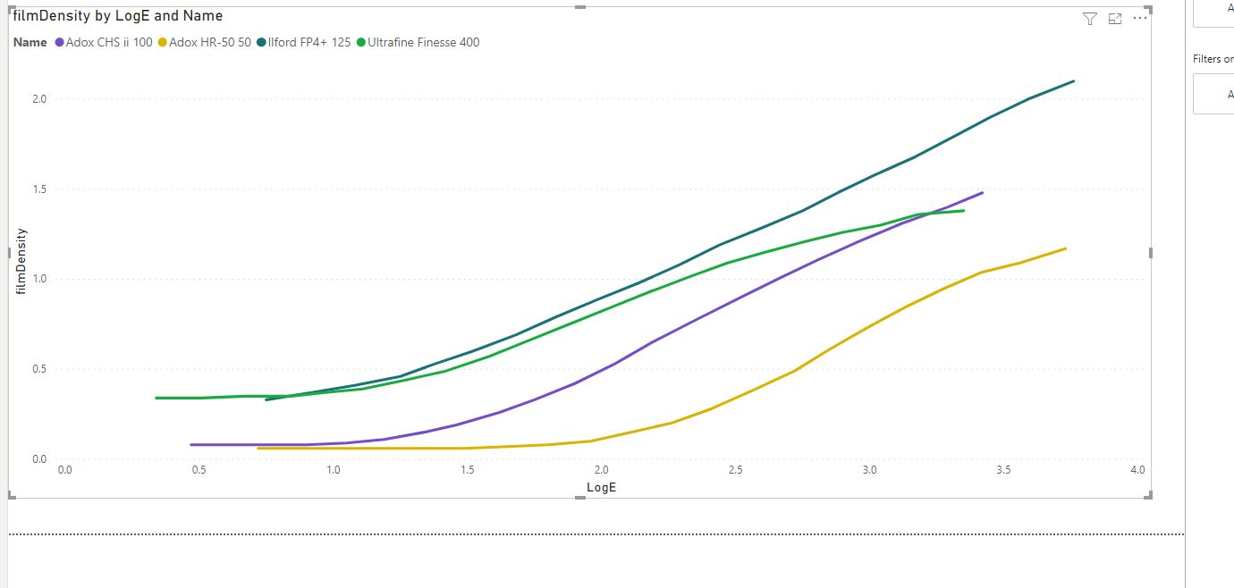

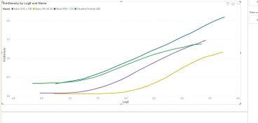

I'm not sure how helpful this would be for folks, but here's my H&D curves of various films, including Finesse 400 which I started testing yesterday. Finesse is the green line (second from the top). Apologies the colors are so close - I didn't pick them (PowerBI did). I also did an H&D on pen and paper and using that I came up with a gamma of 0.57 and CI of 0.50 using the published dev time for XTOL although I adjust my time due to developing at 19C instead of 20C (as that was my room temperature).
I use XTOL-Replenishment with a DIY rotary using a JOBO 2500 drum (with a pre-wash) so I'm not sure if my times will translate but in general I find that my times are usually close to XTOL Stock times which I think makes sense since I've read one should subtract about 15% dev time to hand agitation times when using a JOBO; but likewise XTOL-R adds about 15% more time. So it sort of cancels out. That said, the CI is a little under the Kodak standard (0.56 I believe) so I will likely dev another strip today with a bit more dev time just to see the difference.
I cannot calculate ISO without the CI being closer I believe, but I'm also using my enlarger and not a sensitometer so I don't know how valid that would be anyway.
All said what might actually be helpful for folks is to see the curve. Notice it looks similar to HR50 in that I was able to get both the toe and shoulder within one exposure test. It's not shown here but I did several tests of FP4 (and also Pancro 400 which isn't shown) and wasn't able to capture both in one exposure with those films. For CHS you can see it just starts to curve over a little. This indicates to me that this is a film meant for that "classic" look similar to how Adox advertises CHS ii. For folks wanting a long straight-line, this is probably not your film choice at least based on my testing and developer.
I'm not expert in H&Ds or anything (in fact only recently learned how to do them) but a strong toe and shoulder makes me think the film probably won't push quite as well. I'll try it anyway but I was hoping to try another film other than HP5 to bulk load and for pushing, just to try something new.
Another note, the pre-wash didn't have any color to it at all. AristaEDU 200 (Fomapan 200?) is green. CHS ii is yellow. I think T-Max is purpleish? I had one film that was blue but don't remember what it is. But this was clear. It did have an odor though which smelled a little like Rollei IR but not quite - it was more, erhm, peppery I guess? I realize I'm trying to describe the subtle notes of what's just pre-wash water but even so thought this, plus the above, might be helpful for folks trying to pin down where this film comes from.
I haven't actually taken any photos with it yet at this point - just film tests. I'd like to try to get my CI a little closer but will likely spool up a roll in a day or two, though not sure when I'll finish the roll. I'll shoot that one at box and then start trying to push it.

So quick update, I developed one more test strip with 15% more dev time (9:30 at 19C so 8:30 at 20C assuming Massive Dev's time/temp conversion is accurate). Interestingly, this is the dev times for Silberra U200 (https://silberra.com/films/silberra-u200-u400) and, while I'm in no way making any claims here, it is interesting that my personal ISO (using the Kodak method found in their h470 worksheet) is 284.
I should point out though that my Kodak ISOs are all over the place for various films and aren't all within the +/- 0.05 density tolerance. So I'm not sure I can trust them, although a few seem pretty close when doing some film tests. All told they are:
Ilford FP4: 80
Pancro: 121
Adox CHS-ii: 28
Adox HR-50: 4
In pictoral tests, these don't seem far off except for CHS-ii which I think is closer to 50 or even 100 depending on my metering. HR-50 seems crazy low but I get rather lovely contrast at ISO 3 (at 5:00 dev time). Since it's really meant for using HR-Dev it's possible for the contrast I want, that's the ISO I need to be at.
Of note these also may not translate to anyone else as it's my XTOL-R solution and it's possible it's causing some speed loss (though XTOL is normally known as a close-to-box speed developer). I normally replenish at about 80ml per equivalent 35mm/36-exp roll and using a 2L solution.
So all told I think I'll try Finesse at either 250 or 320 as a base and see where I land.
EDIT: Aha, hmm while my tests seem to be not too far off from these ISOs, at least on the films I tested, I think what is throwing the ISO ratings off is either my lux meter not being especially accurate and/or using an enlarger (over a sensitometer) which undoubtedly has lag to reach full brightness. I could test the latter by using a shutter but I don't think I could light proof my enlarger well enough to avoid some light spill. I still think I'll try Finesse at a slightly lower ISO just to see though.

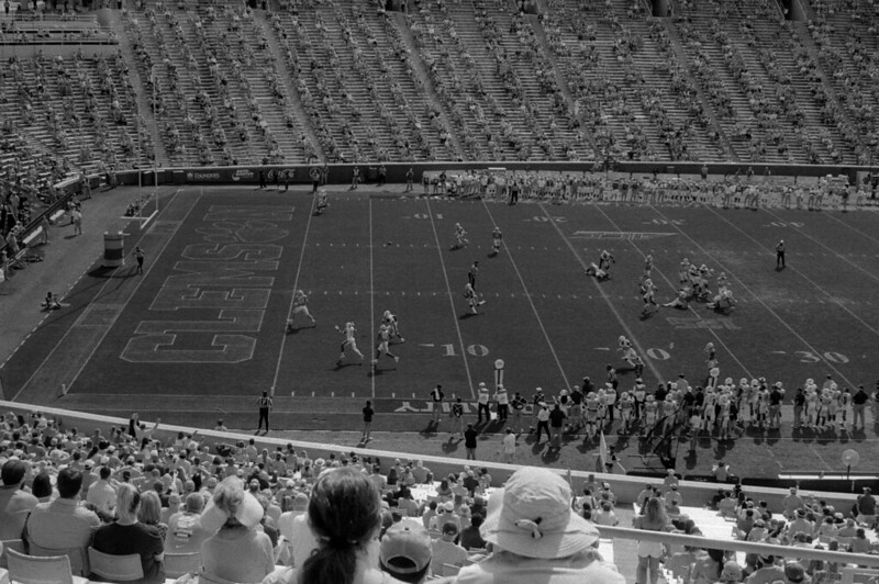

I just finished a roll in D76. Looks pretty good to me. I shot this yesterday while testing a new (to me) N2000. This was in Program exposure mode at box speed. I've processed a couple rolls in Rodinal, and they looked similar to what I've gotten with HP5, where the grain is there, but not objectionable like Arista Edu 400.
