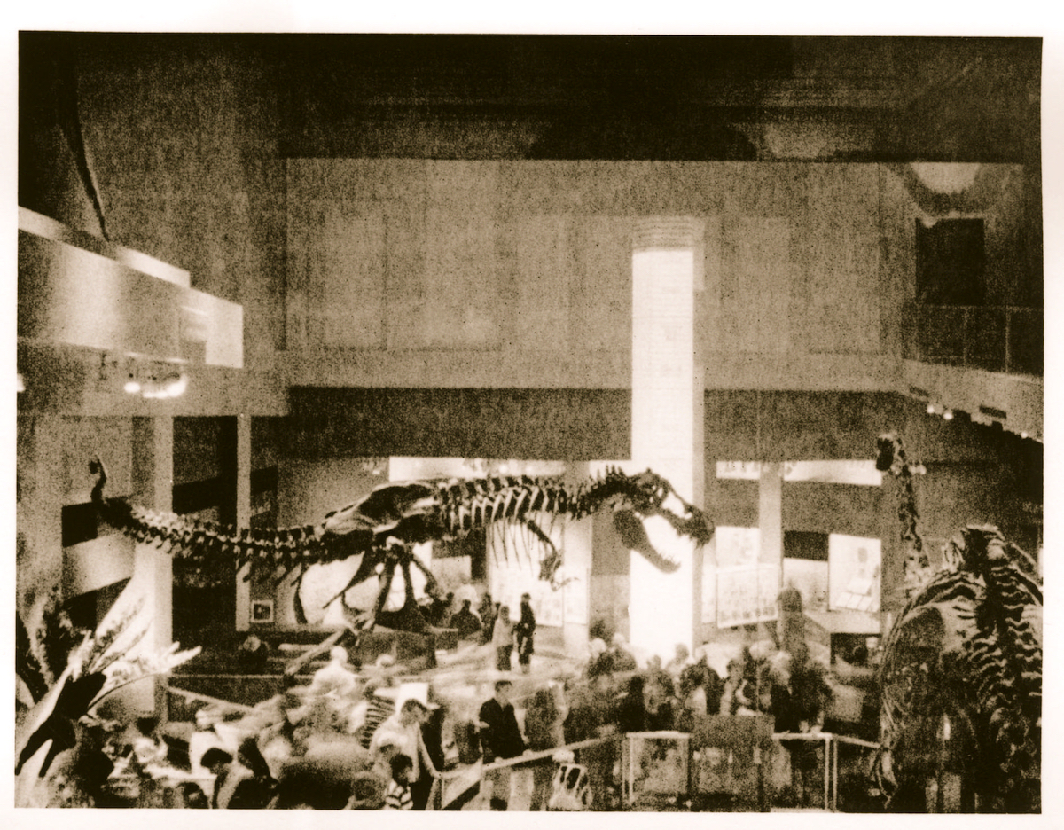

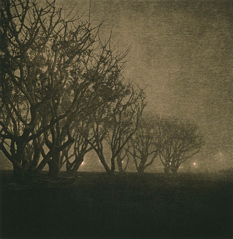

Cool museum shot. That’s kind of the color I get with F4. F3 comes out neutral gray.

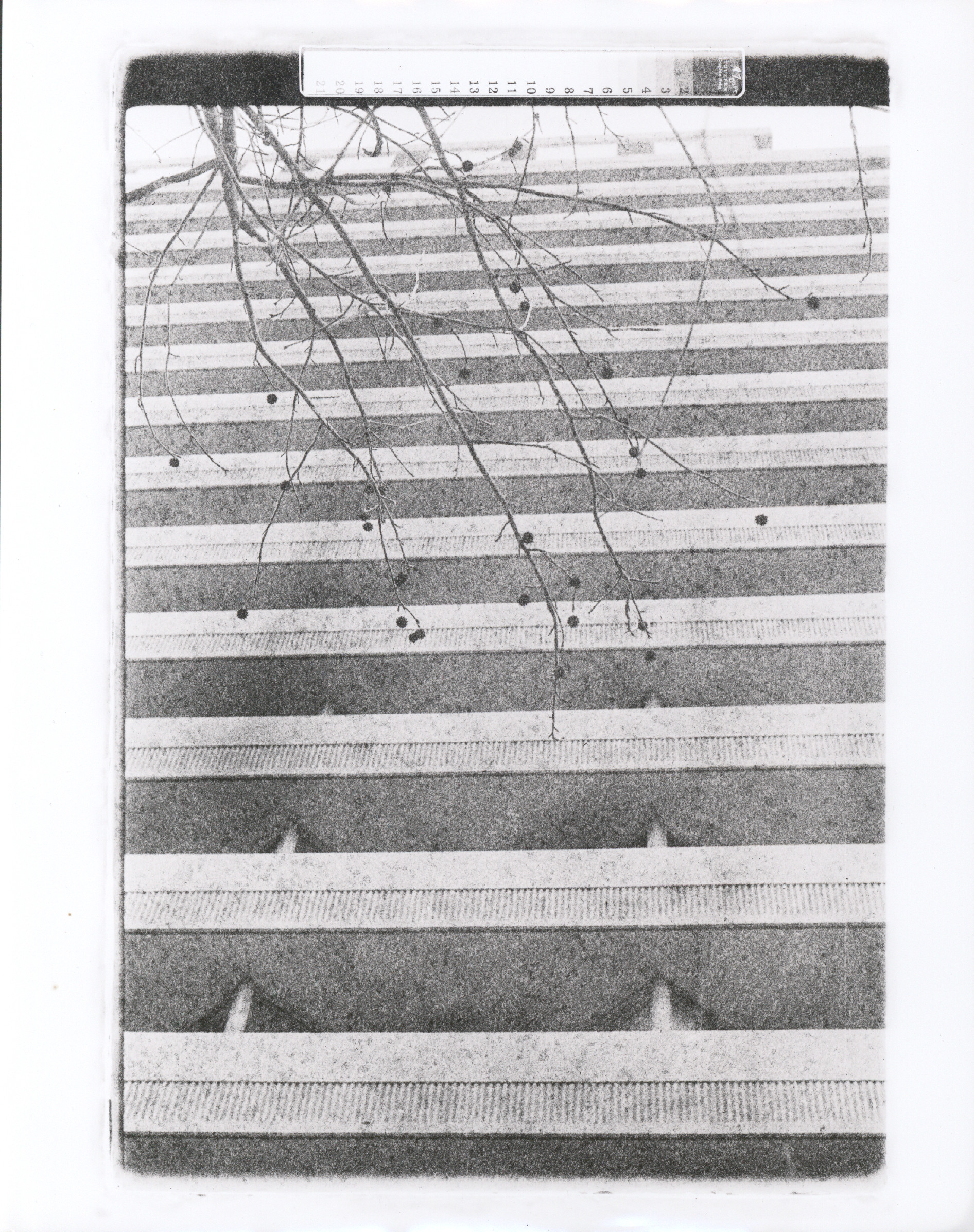

First Result. Can you believe it???? OK this is literally print number 2 because the first one has serious issues because of the ridges in my tray.
But right off the bat! Just hit it with two minutes exposure for an illumination level that would have normally been 32 seconds.
I used 2 minutes exposure for all subsequent prints to date. Wild that print exposure time is "meaningless" when you do Lith printing.

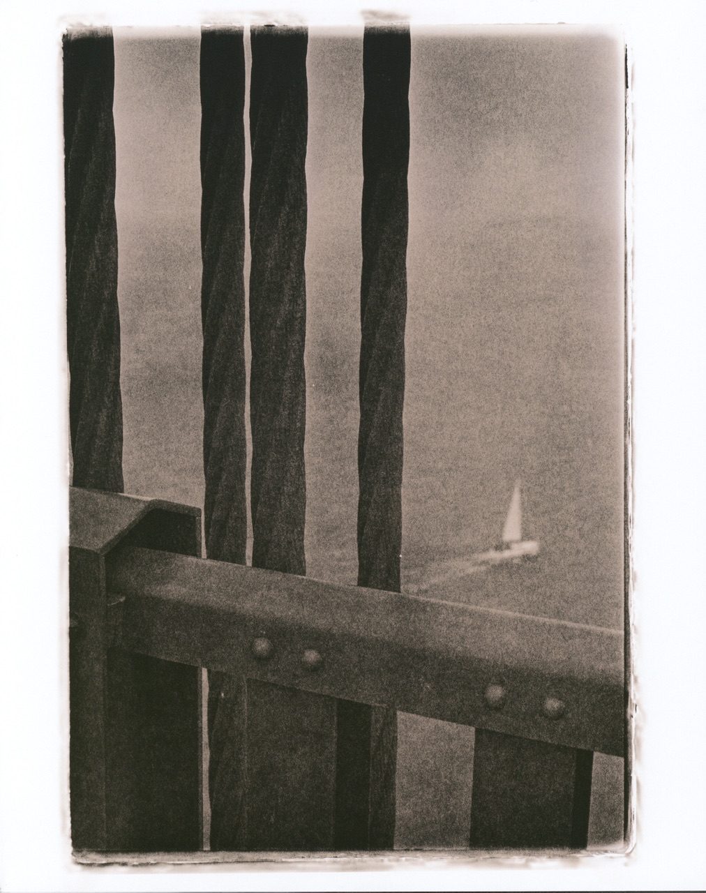

I told some of the rest of the story earlier. But... This was one of the negatives that really needed the contrast treatment.
Before I did the sailboat, I looked through my recent scans and I got to this one and "chimped".
I
11x14 Kodabromide F4 Single Weight.
2 minutes exposure, second print in Moersch 15ml A + 15ml B + 375ml water, about 8 1/2 minutes. KRST 1:20 ( but the selenium toning didn’t change the tone much, it came out of the fix like this).

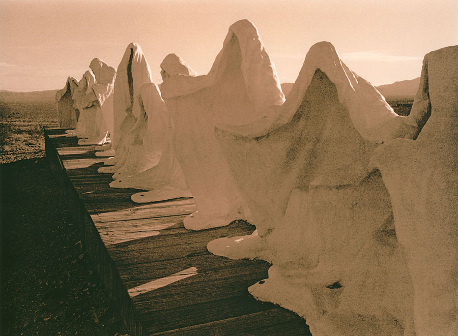

You've gotten plenty of great technical advice here from others, but my 2 cents is that longer exposures will generally provide a greater density and range of tones in the mids before the shadows start to get too dense. Many papers will also be more colorful with longer times. Toning can also have a great impact on the final print color.

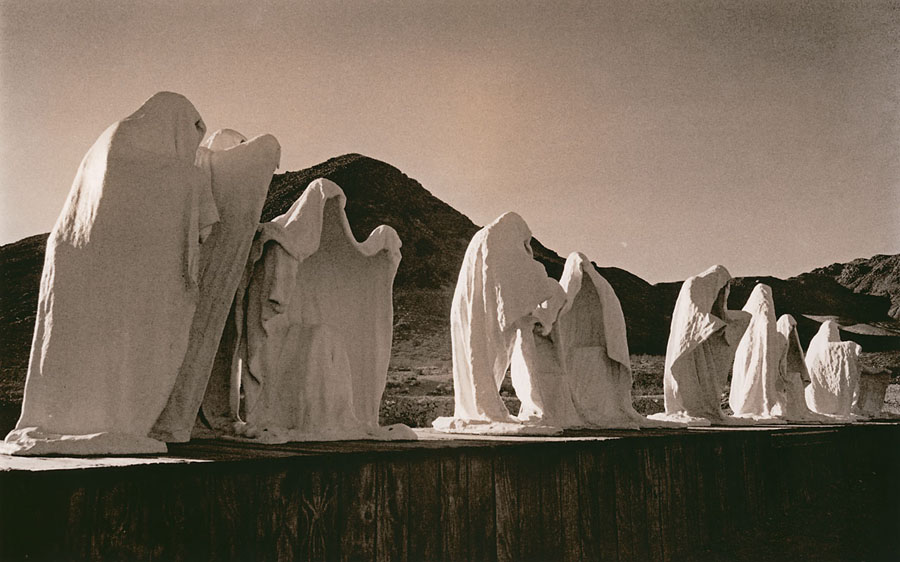

These two were printed on Fomatone 131 paper with Fotospeed LD20 developer (sadly discontinued).
First image was not toned, but the second was toned with selenium to give a cooler look.
Thanks jimjm
That’s quite a scene!
How strong was the selenium? I hardly see any difference with KRST 1:20
P.S. I routinely use KRST at 1+3, especially with cold tone papers. 1+3 is way too strong (well it's harder to control) with warmer papers like Fomatone. 😊

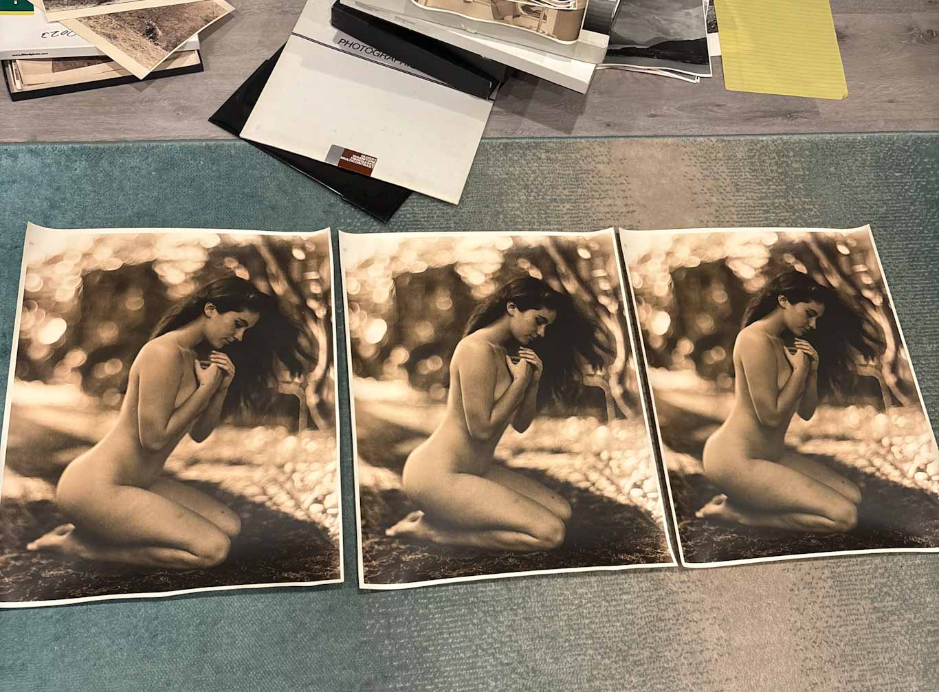

I also use the one shot method except I take it a step further by priming a big batch of developer in a big tray, usually about 2000 ml. (Maybe that’s not a big batch for some of you but it’s enough for me to make 3 or 4 prints in an evening). Depending on the paper I plan to print I will add a certain amount of old brown to the mix. Some papers need a lot of bromide and some will barely tolerate it without pepper fog. I also throw in a sheet of some junk paper like some old fogged RC. Then I let it rock for a while. I use a laboratory tray rocker (also heated) so that does the work for me while I do other things like set up the enlarger. When you’re printing long expired hard to find papers, the name of the game is not to waste a sheet if you can so getting the developer seasoned like that gets you past the first one or two not so interesting prints. Once I have it ready I pour it back into the pitcher, switch to a smaller tray and start making prints with about 600ml per print, give or take. Assuming I have my exposure time just right and I don’t have to adjust it, I can make multiple nearly identical prints without wasting valuable paper.
Here is an example, 3 sheets of 16x20 Ektalure made with one batch of developer.
