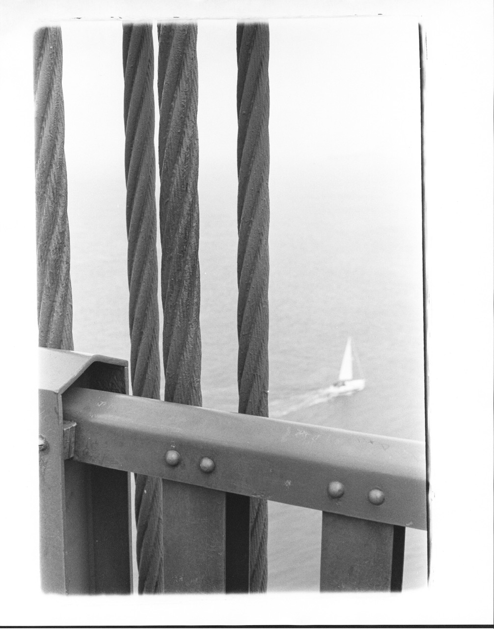

I’m about to do some Lith printing for the first time.
A roll of film from the Golden Gate Bridge left me feeling like they deserved a high contrast graphic treatment instead of a straight Silver Gelatin print approach.
I couldn’t get the contrast I wanted with stock print developer and Kodabromide F4 11x14 Single Weight paper.

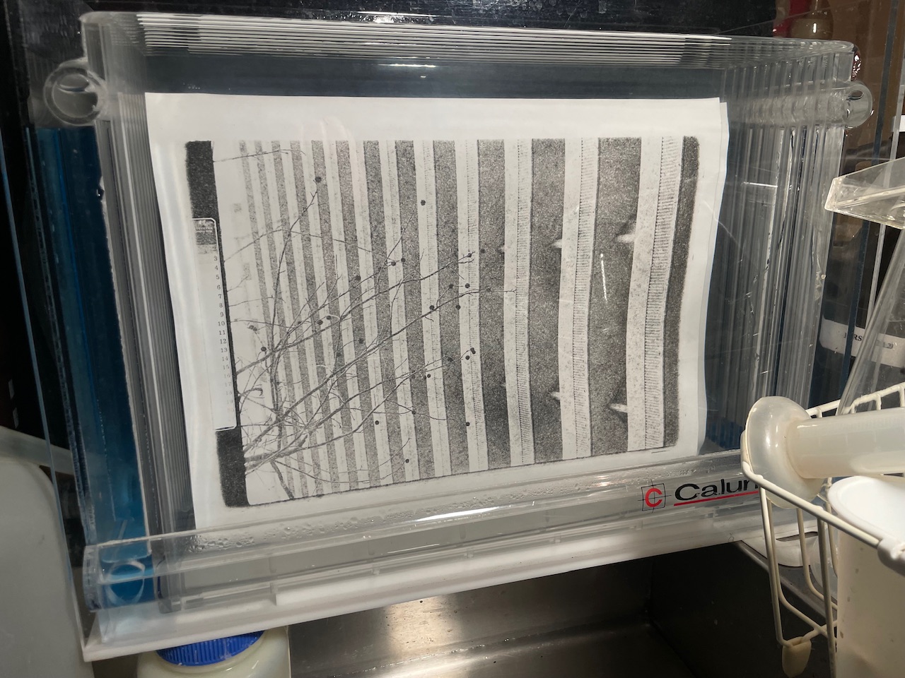

My first experience was fun. Learned the value of a flat bottomed tray. My first print had ridges.
I used 20ml A + 20ml B + 500ml water.
Used analyzer to guess a normal exposure would be 32 seconds f/5.6 so I gave 2 minutes.
About 8 minutes to snatch point.
Found an 11x14 picture frame so used the glass in the tray for the second print.
About ten minutes to snatch point.
That came out pretty nice but thought I saw ridges from the stop bath.
Third print took 19 minutes. I thought I saw a bubble so rubbed it down. I think I accelerated the development in that spot. Or maybe the safelight isn’t so safe.
Fourth print, thirty minutes and pure white. I held up cardboard to protect the tray from the brightest safelight. Next time I’ll rig a clip, my arms got tired.
I remember the old days, that feels about how I remember lith developer goes bad fast.

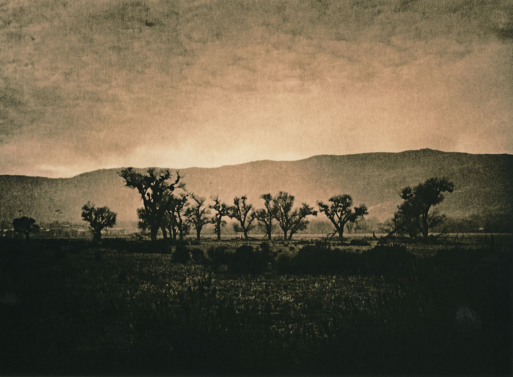

This is the second print that I think is the best:

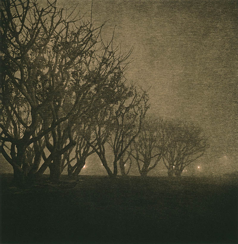

Love lith printing! It can be very challenging at first, but can result in some unexpected surprises. So many different variables in materials and technique make it exciting for me.
I've had negatives that I never really printed to my satisfaction in traditional B/W, but were transformed when I tried them as lith prints.
I need to have a reasonably bright safelight while developing because the shadow snatch point is critical and my "night" vision is not so good anymore.
I've used a lot of different papers - Foma 131 has been good for a current paper, but my favorite has been old Forte Fortezo. Old Oriental VC-FB warmtone has also been good. I recently bought a box of Slavich Unibrom from Guillaume which I am really eager to try out once we finish our move up to Vancouver Island and I get the darkroom set back up.
Moersch SE5 lith developer is pretty much my standard now.
Both these prints were made on Forte Fortezo using Moersch SE5 developer. Similar subjects but very different lighting situations and challenges during printing. Neither one really worked for me as a standard print, but lith really seemed to sing to me.
