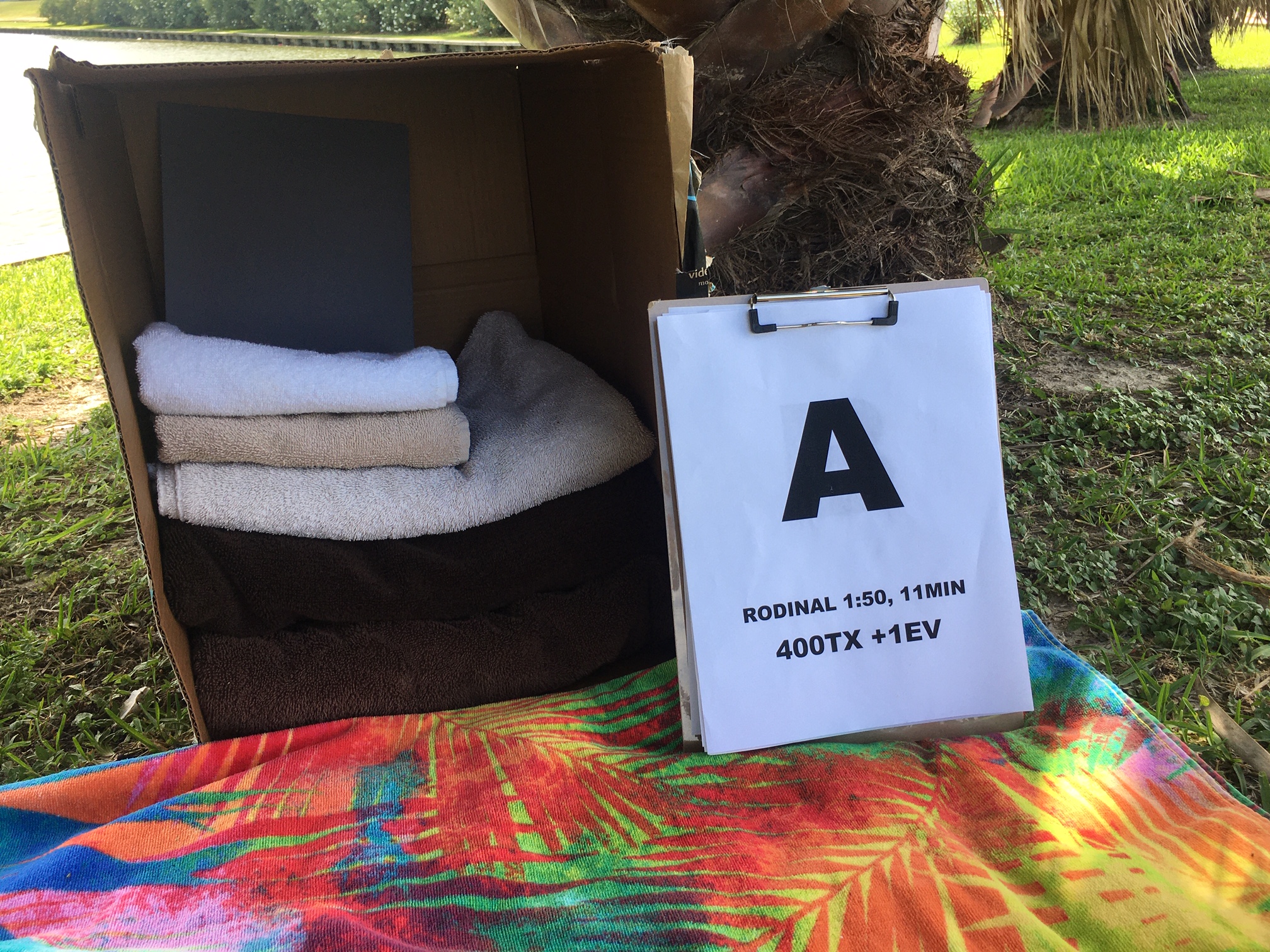

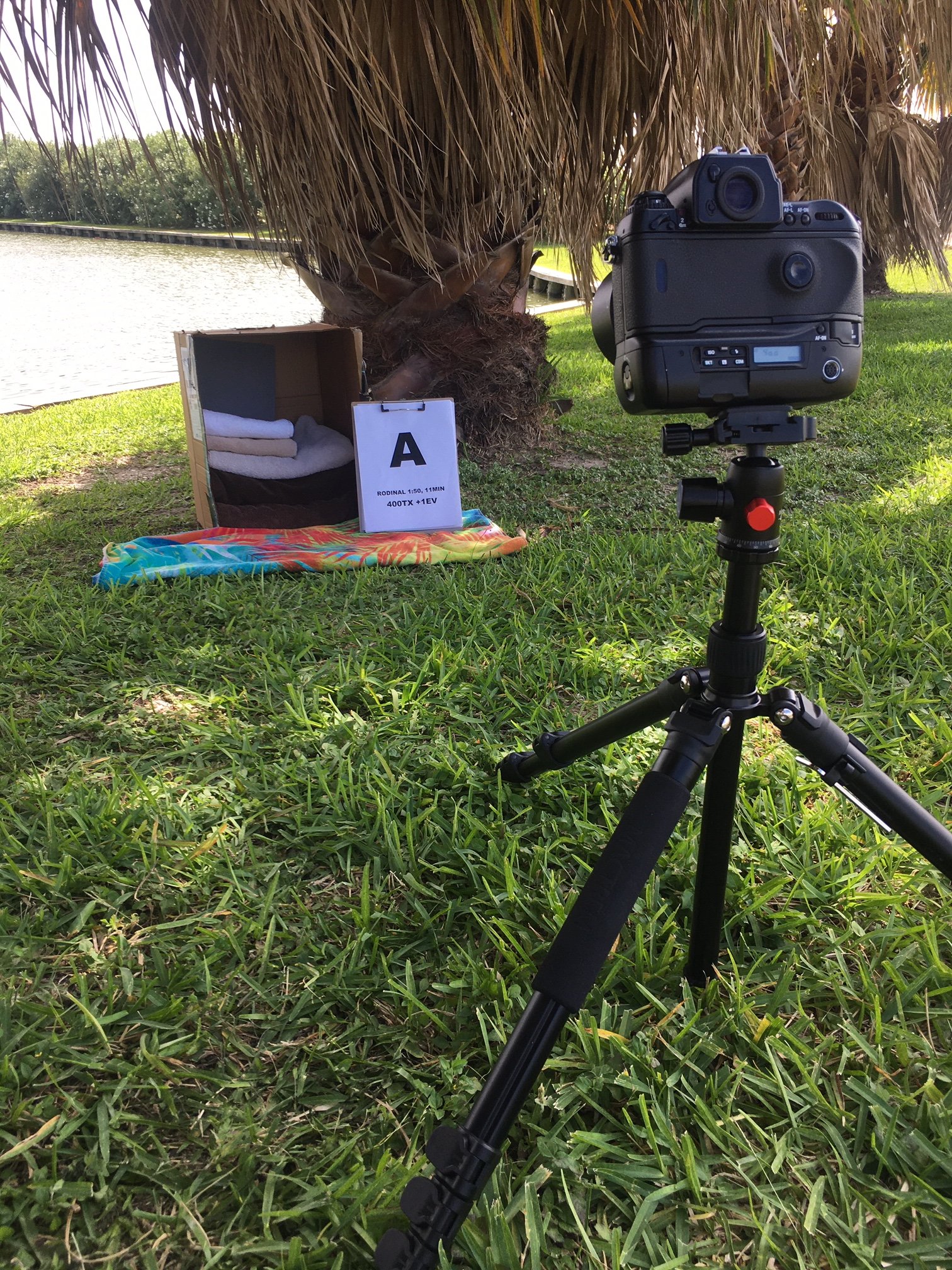

I started my experiment today. I shot 6 rolls total, and each roll is divided into 12 frames of +1EV, box speed, and -1EV. Three will be developed in Rodinal 1:50 at 11mins, 13mins, and 15 mins respectively. The other three will be developed in HC110 for 3.75mins, 5.6mins, and 7.5mins respectively. Everything will be processed at 68ºF if I can manage it, if its too difficult then I'll get as close as I can and adjust times per the Mass Dev Chart.
I shot everything in Aperture Priority, at F/8, and noted the shutter speed for each set of exposures. Weather was bright, but mostly cloudy. It didn't change much at all through the shoot though. I started the first roll at 3:18pm, and ended the last roll at 3:42pm. Each roll has a set of notes as well.
The box was filled with different color bath towels, as well as a gray card. Below is some phone pics of how I set it up. It was set up in the shade of palm trees.
ETA: Everything was metered TTL with center weighted metering.
