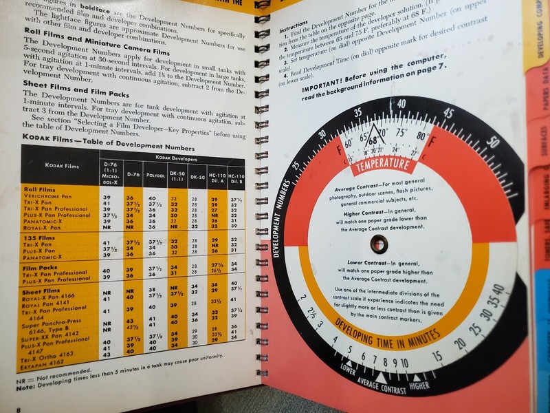

I'm sure that function is useful, but I prefer the analogue approach - just spin the dial in one of my Kodak Darkroom Dataguides:D.
One of these:

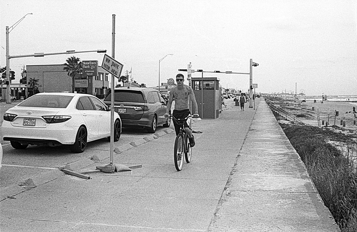

These are better, but I'm still not satisfied. Tri-X 400, 1/500th, F16, Rodinal 1:50, 12 mins. 10sec agitation each minute.
These are still much to grungy for me. Not sure if it's the camera/film combo, for film/developer combo, or what. But these aren't doing it for me.
Hmmm, for my taste they need to be printed down harder. The highlights aren't printed down enough and when you bring them down you'll get nicer blacks. Just my $.02...
Hmmm, for my taste they need to be printed down harder. The highlights aren't printed down and when you bring them down you'll get nicer blacks. Just my $.02...
They’re just straight scans right now.
