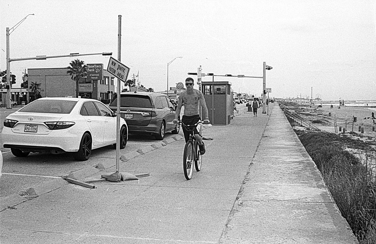

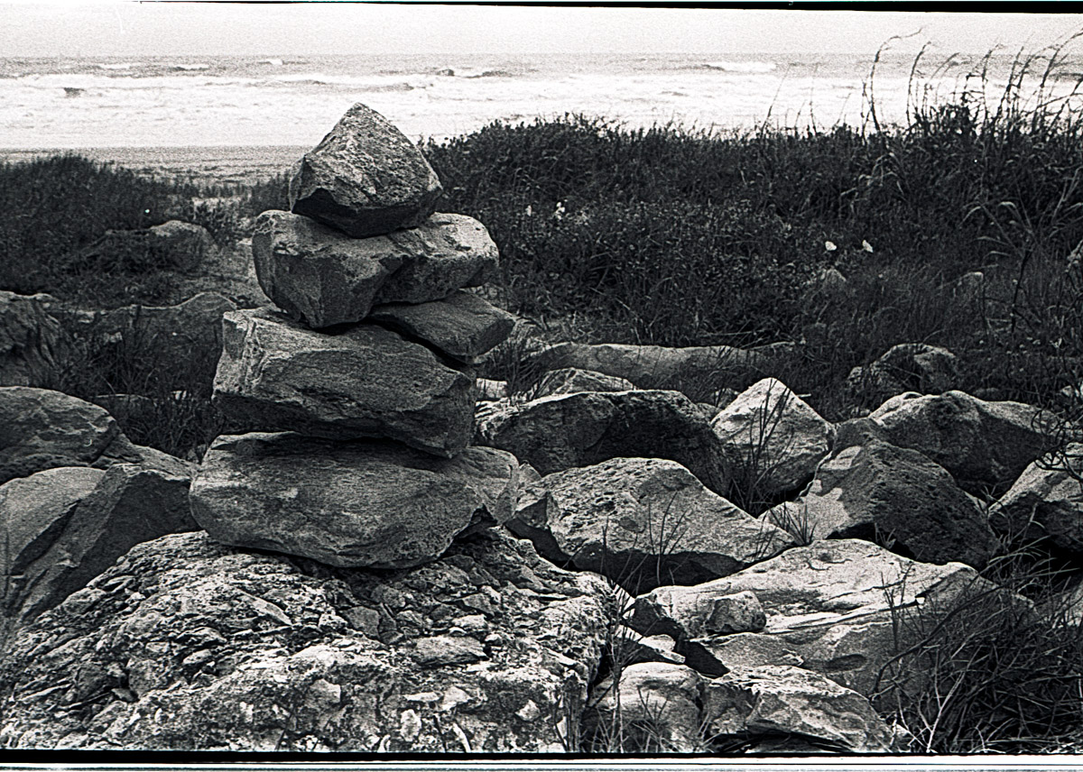

These are better, but I'm still not satisfied. Tri-X 400, 1/500th, F16, Rodinal 1:50, 12 mins. 10sec agitation each minute.
These are still much to grungy for me. Not sure if it's the camera/film combo, for film/developer combo, or what. But these aren't doing it for me.
Still too much contrast, but who can tell how much originates in the film and how much originates in the scans.
They will probably look better as a wet print. What was the lighting like that day? Looks overcast, images look about right for such flat lighting.
It was very gray, very overcast and cloudy, and very windy and cold.

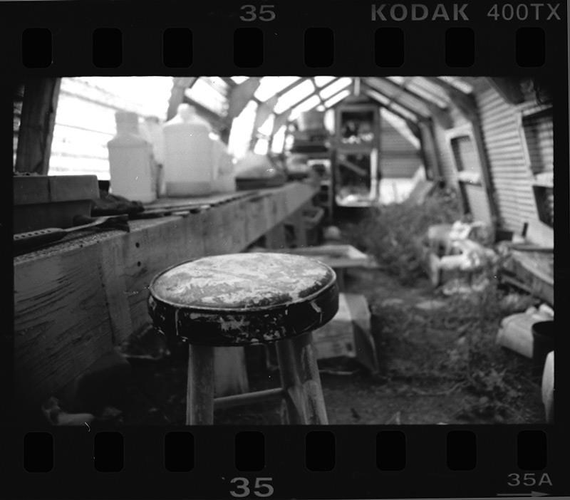

This is what I'm used to with TriX. This was shot with a fully manual Nikon FM. The contrast doesn't bother me, but this looks a lot more smooth than what I'm currently getting. I think I'm going to have to go back to D76 or HC110.
Greenhouse by Christopher Coy, on Flickr

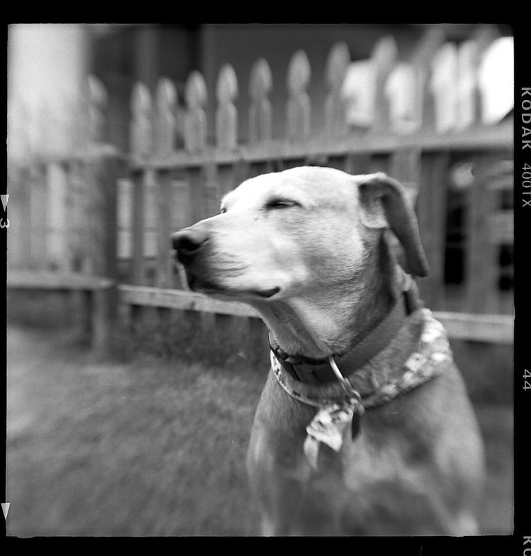

Even this one, which was shot with a Kodak Brownie with a flipped lens, looks a lot smoother and not so "newspaper" like.
wranglerhawkeye by Christopher Coy, on Flickr
In my eyes only the rocks pic looks too contrasty. The bike and the seafront scene looks OK contrast wise. I take it that the 12 mins was at 68F? If the scanner operates the same way when doing both straight scans then it has to be that the meter was fooled into overexposure for the rocks, doesn't it?
The second roll (rocks and bike negatives) were shot with the Yashica Minister D. Every frame on that roll was shot at ISO400, F16, and 1/500th. I metered a few spots with the "pocket meter" app on my phone, and left it there.
Thanks It suggests to me that the rocks' exposure needed to be different from the sea-front scene. I have an Agfa Isollete I with very limited speeds of only three and no metering at all. As a result of that I tend to use one aperture setting and one of the speeds but it is a compromise and as a result my contact sheet always show quite a variation between the shots. The same aperture and shutter speed is OK and there may be little scope for variation with the camera involved but it is not ideal in my opinion

They're underexposed. 1/500 @ f/16 is for full sun, which you don't have in these pictures, and even then will often leave the shadows with too little detail. And in Rodinal, TriX probably doesn't reach ISO 400 anyway. I'd try with two stops more exposure in this lighting, maybe even three. The underexposure means that you, or your scanner driver unbeknownst to you, need to bring up contrast in the shadows, which increases grain. Obviously you need to rethink your metering, educated guessing (sunny 16) should be more accurate than this.
