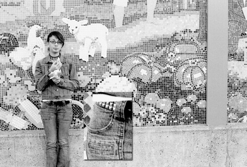

Okay here's a first frame -- I'm going slowly, sorry
Pacific Grove, Monterey, 2005
HP5 645 negative, Rodinal 1+100 stand dev'd 2.5 hours
Click the image to see a larger version on flickr
Tri-X 35 to come...

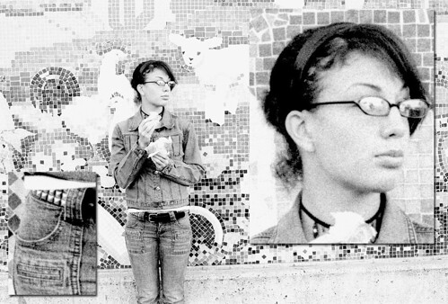

Here is 35mm Tri-X at effectively ISO 1600:
Here it is down a stop (metered ISO 3200):
As ever, click-through these to see a larger version.

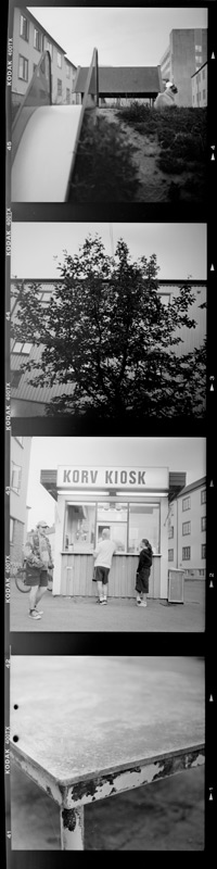

See attachment for examples of unevenness.
timeUnit said:
The big problem: uneven development. There is more density on the "left" side of the negs than on the right. I guess the developer has "sunk" and there was more activity at the bottom of the tank.
Interesting -- didn't get that. I think you're starting to fog actually. I ran the HP5 120 on the bottom of a tall tank (HP5 less vulnerable?) and the 35mm tri-x on top of that (where the variation is less pronounced)... looks like a better timing for TX might be something shorter, before this fogging might set in. Or maybe give it one inversion at mid-time... try stuff, it's that simple -- especially considering that the idea is to find something in the particular character of any process that meshes and appeals to something specific in your own shooting: overexposed, underexposed, they all have the potential to look like SOMEthing, to mean SOMEthing. It's the finding out and grasping that's half the fun
Yeah, you're right. Experimenting IS fun. And I think you might be right about fogging. One can see that the film base is denser on the left side. The base definetely didn't get any exposure, so there's something else going on. I'll try it again sometime. The pictures were crap anyway, so it's no loss. :smile:
