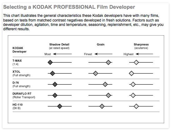

Actually, it shouldn't be that different at all between 1:1 and replenished, not game changing different anyway.
Kodak themselves claim Xtol is a lot sharper than HC-110 and also exhibits finer grain, so something is not right.
