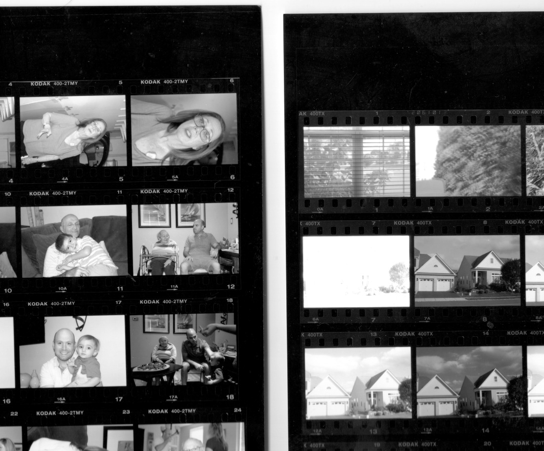

Here are two contact prints of 35mm done by a prolab. Not sure what developer, probably XTOL. The lef one is Tmax 400 and the right one is TriX 400. The right TriX seems lighter than flat scan I did of the film. Is the contact light because the print wasn't printed right or because of the negatives or developing?

I expect the lab has a standard procedure for contacts that isn't fine tuned for each film. If you were doing your own contacts, you might very well adjust exposure slightly when you switched between them.

Sorry Bill. I should have mentioned I was referring to the rebate area, not the actual shots. It's lighter there with the TriX.
Oh, no worries. That's probably not a real difference. Adrian Bacon is studying fog that he sees increases with increasing pH (as the developer is more active when the developer is more alkaline), that would appear exactly like that under controlled contact printing conditions. It's possible the difference between your two contact prints is fog, but probably not. The lab probably just casually created contact prints for you without being too careful to control exposure.
