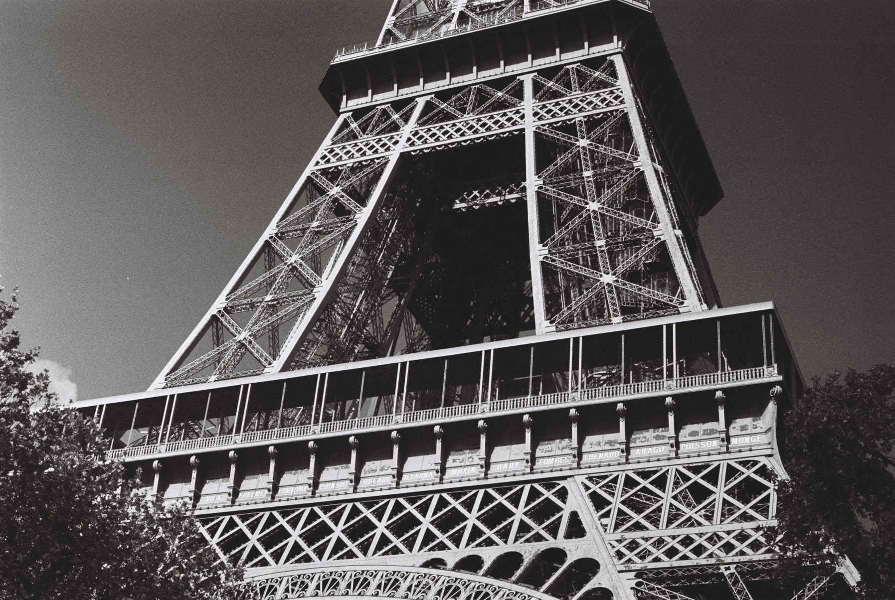

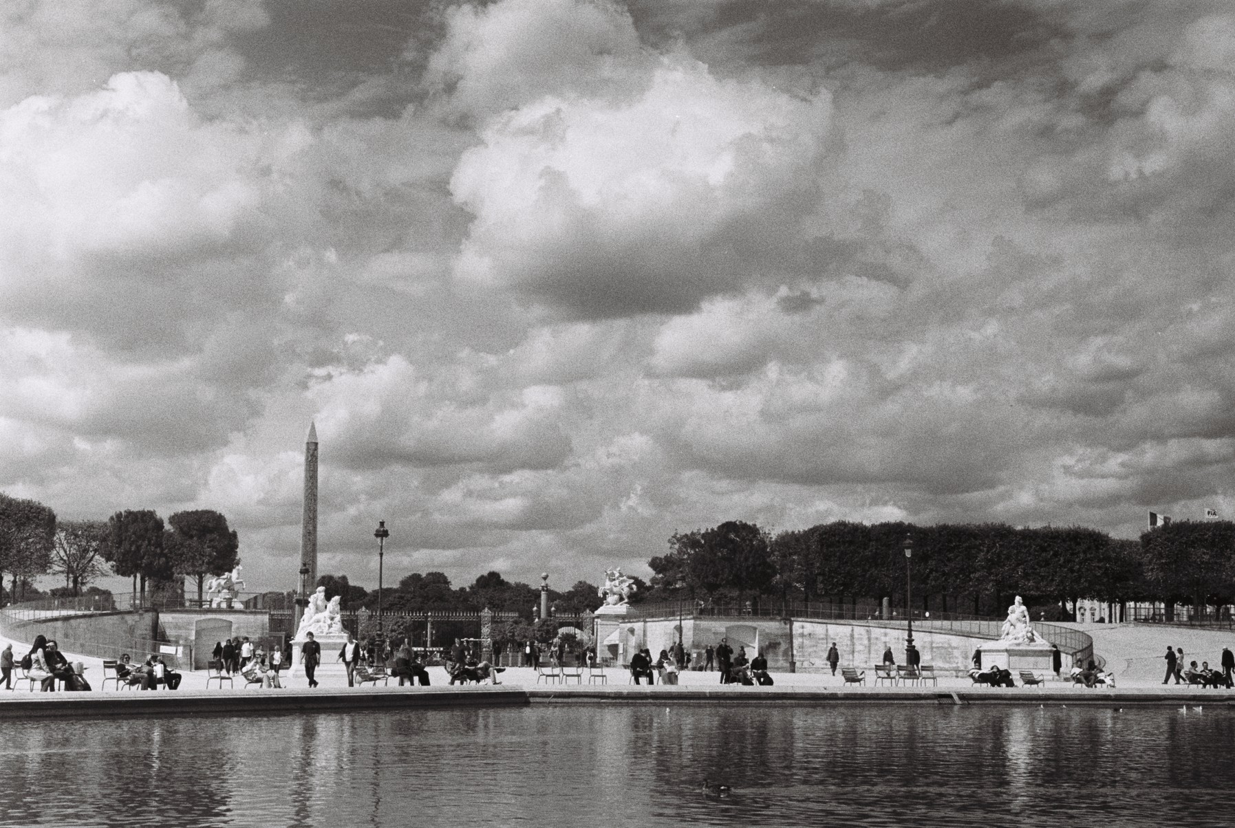

Here an example on 35mm with yellow filter. In medium format the grain is more subtle and elegant.
Apart from that the film is quite high contrast and punchy:

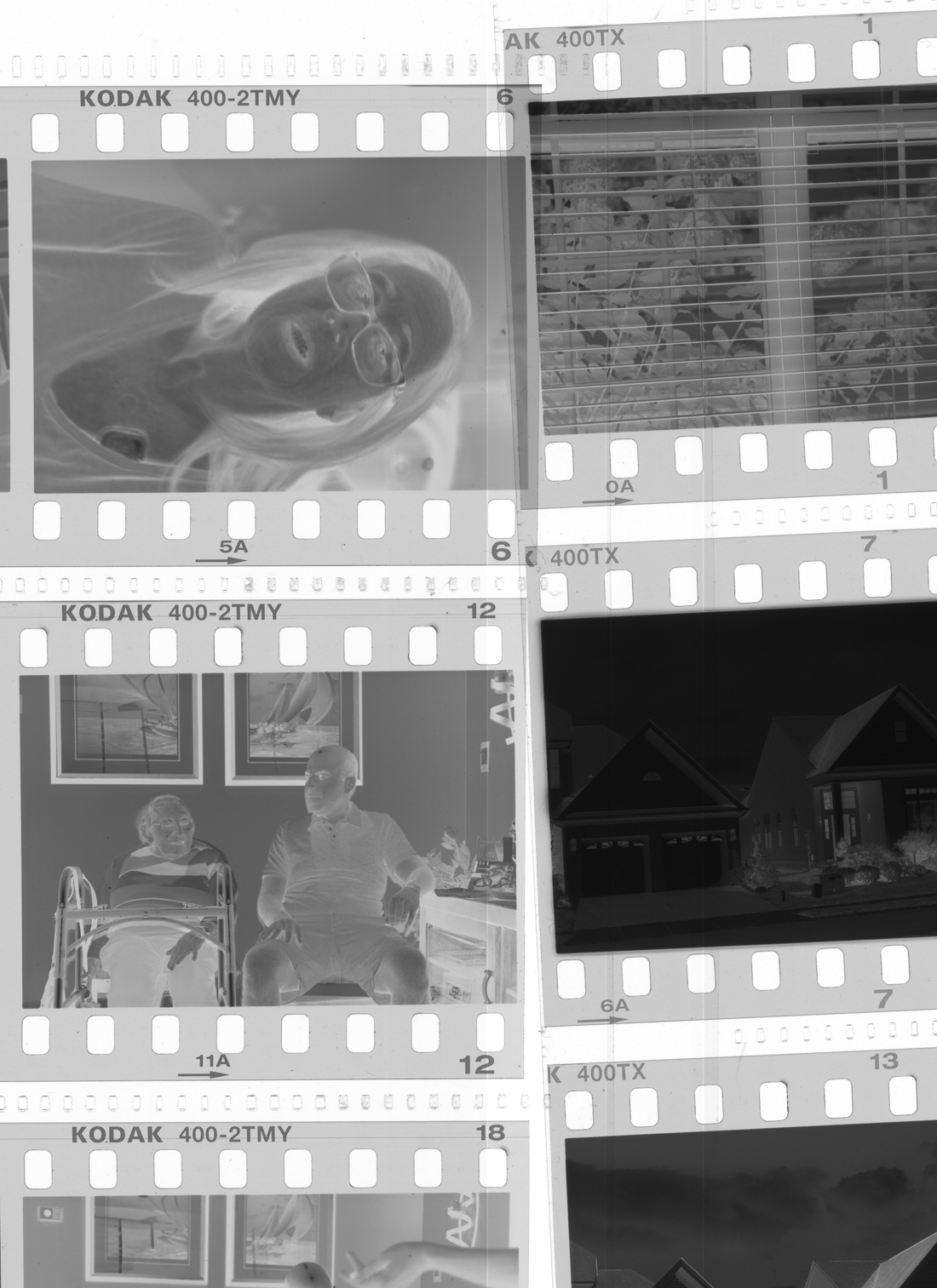

View attachment 232934 View attachment 232935 View attachment 232934 View attachment 232935
Here are two contact prints of 35mm done by a prolab. Not sure what developer, probably XTOL. The lef one is Tmax 400 and the right one is TriX 400. The right TriX seems lighter than flat scan I did of the film. Is the contact light because the print wasn't printed right or because of the negatives or developing?
So to clarify a little, I scanned the negatives as positives. Are there a difference in the processing between the Tmax and TRiX or just the way they printed the contact in my original post?
Bill Burk
Feb 9, 2010
9,425
@Alan Edward Klein, It does look like the Tri-X has a "little" more fog than the TMY-2.
I just developed some of each... I'll take a quick densitometer reading and let you know if I see similar difference.
Bill Burk
Feb 9, 2010
9,425
I think the difference in density in your results might be just different results from the same lab at different times.
No significant difference in my results, 35mm film developed in one tank for 13:30 in D-76 1:1.
TMY-2 and Tri-X 35mm had similar base+fog for me about 0.25.
In 120 I had less base+fog, this is normal because 35mm has a slight tint for anti-halation that 120 does not need because it has black paper backing.
Here's the readings.
120 TMY-2 : 0.18, 0.16
35mm TMY-2 : 0.22, 0.27
35mm Tri-X : 0.26, 0.25
