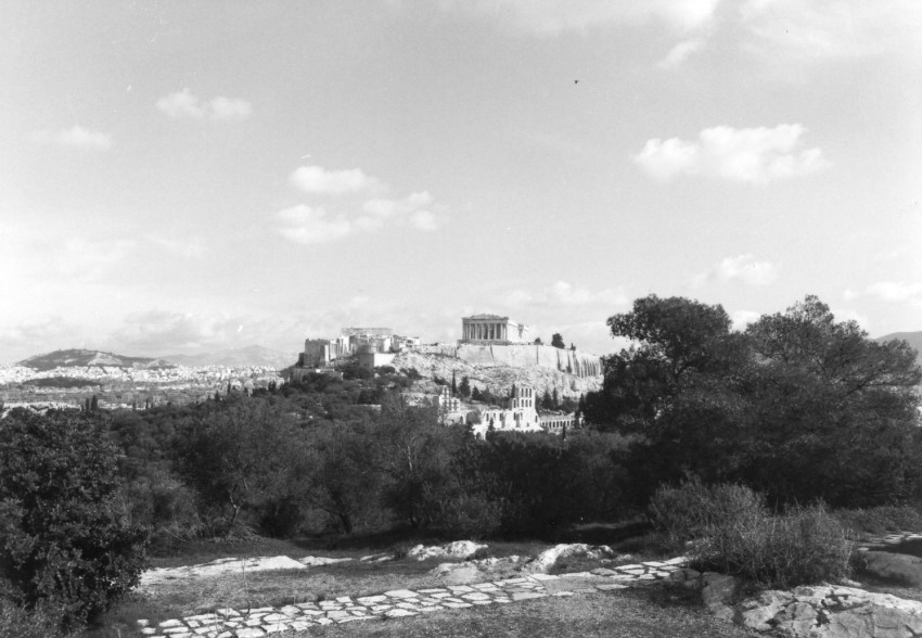

Well, here is my print of antmar's reverse negative on 5"x7" Multitone Glossy RC. My cheap V500 scanner refuses to make the left/right edges of the sky look like the print with RC paper(washed out reflections or something).

Well, just pulled the print off the drying stand:
As I have an enlarger with the ability to tilt the negative carrier stage, I was able to use that and spread the focus across a tilted easel. This allowed me to correct the slight keystoning of the image.
Details:
Beseler 45MX, Nikkor EL-50/2.8
Overall exposure @ f/16 for 25 seconds, sky burned in at f/11 for an additional 40 seconds
Ilford MGIV Multigrade paper, Multigrade developer, stop bath & fixer.
