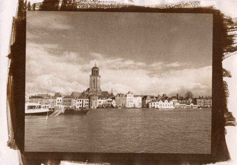

And here is the salt print from the sandwich with two negatives (a bit under exposed):
It's very thin Masa paper, thus the wrinkling after drying. I'll soak it and dry it again taped to glass to straighten it. I got a decent print with this paper. The others got all kind of problems: they all got blisters all over the prints. Probably due to bad and uneven coating with the silvernitrate. They also did it on a newspaper and I'm guessing the newspaper also sucked the silvernitrate straight through the Masa paper. I placed mine on glass and then coated with heavily a brush.
I used the traveling negative and a negative from the cityscape of Deventer, overlooking the river IJssel. I positioned it thus that it looks like there is a village upon the bridge. I gave it an exposure of 2.5 minutes in the full sun but it could have used up to 4 minutes. Anyway, my free interpretation of the Travelling Negative (while testing the Masa paper).
This is a normal albumen print made from the other negative (to compare):

Thanks Darko,
Which one do you like best (if ignoring the smudge marks in the last print)?
Hard to say, but if I must choose :smile:, then salt print on Van Beek paper I like best, it has nice contrast, and in the same time details are clear, all in all very pleasing effect with nice color.

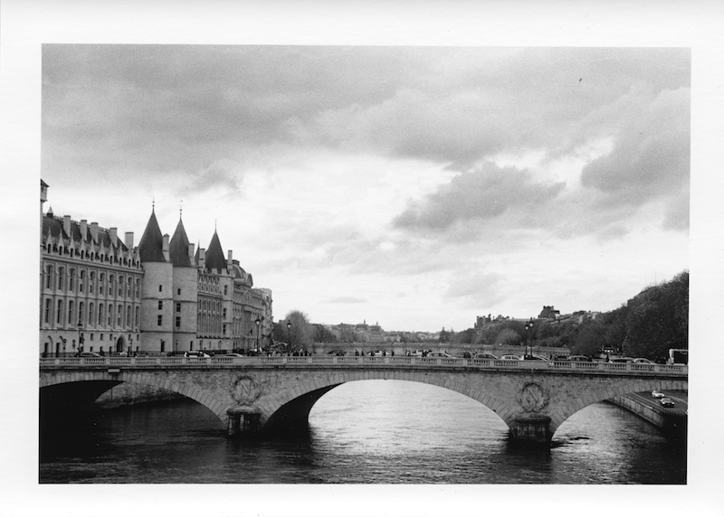

Many months after printing, I'm here to share my interpretation, long overdue, but better late than never.
All prints on Ilford Multigrade fiber base warm tone glossy, developed in Harman Warmtone developer. Almost-straight scans from prints with only a few (and certainly not all) specks of dust retouched and a bit of sharpening (local contrast).
After a test strip, I started off with a straight print:
I thought the lower left could use just a bit of dodging, and was curious to see the effect of burning the sky/clouds. Second print, lower left -1/6 stop, sky +1/2 stop:
I liked the look of the darker sky, so for the third and last print, I went a bit further with burning (lower left -1/6 stop, sky + 5/6 stop):
So there you have it; depending on the mood I'd want to convey I'd choose the second or the third print. Or, if it weren't a travelling negative, I might by now revisit it and print it differently.

I know this is an old thread and I'm slow on the uptake sometimes but..
The print in post #233 - it was made from an in camera paper negative ? Of what size? and, what size it this positive print?
I's lovely.
Thanks,
Robert
Hi Robert, and thanks! :smile:
It was made from a 35mm film negative that Darko sent around.
The basic process was:
  • Enlarged part of the negative onto 5x7 paper to make an "inter-positive"
  • Contact printed the inter-positive onto another sheet of 5x7 paper to make a paper negative.
  • The paper negative was then used to make the print onto a piece of printing paper.
If I remember correctly, the paper is 9.5x7 inches, and I probably used a mask to get the clean border.
If you read the following links it's going to make it seem a lot more complicated than it really is... there's nothing very difficult.
Probably the only difficult part is knowing what a good paper negative for this process looks like, and that just takes a little practice.
Here is a link to the process for making the paper negative
and
Here is a link to the process for making the print
Cheers!
