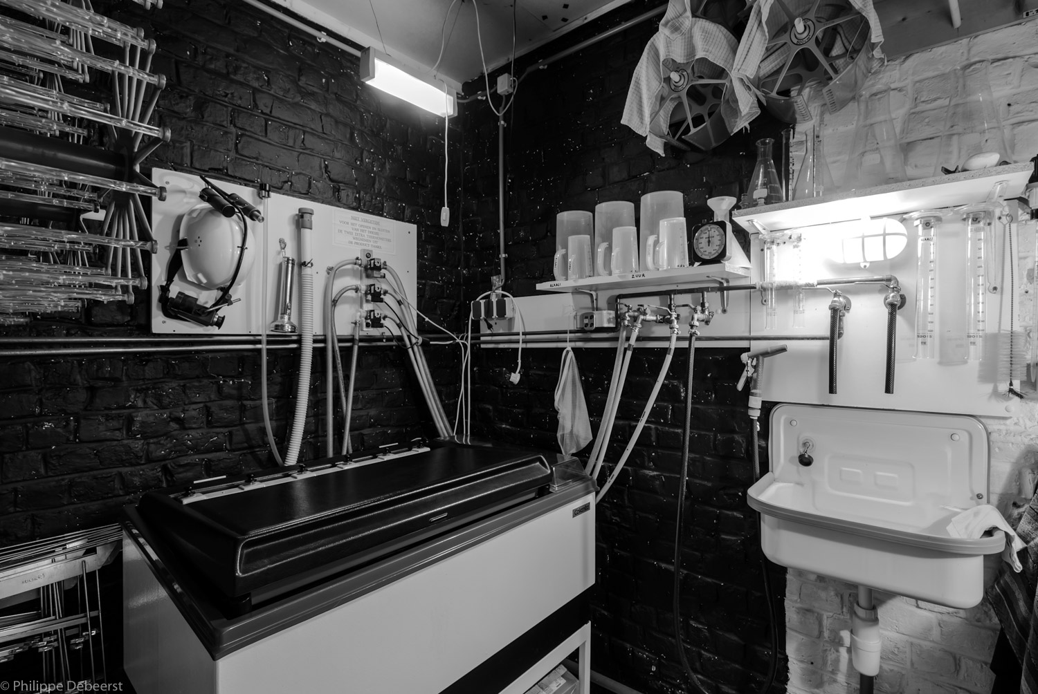

No, as a matter of fact, I am thinking of selling this Rolls-Royce of the small professional developing machines.
It can develop all kinds of formats, ranging from 35mm rolls till 24x30cm sheets, in all possible processes imaginable due to an easy to program built in microprocessor.

my Colenta (home-) developing machine had a diameter of about 30cm, a 120 roll film could be wrapped around, emulsion outside, in ONE turn (not overlapping),
Delighted to hear about your Colenta. The only problem I found with them was if a clip was dislodged during the process it could catch in the drain trap and keep it open and so the next bath would just drain out. Other than that they were a great machine for their time.

In the more than 25 years I worked with this machine, I only got this clip problem only once. Then I bought an Infra Red viewer, a used one from the AGFA-Gevaert factory in Mortsel-Antwerp. So I could interfere when this incident happend again, luckily it wasn't necessarily.
But that viewer was very useful anyway.
Is there any information on these machines online?
hardly...

BTW the film 'spirals' in my Colenta (home-) developing machine had a diameter of about 30cm, a 120 roll film could be wrapped around, emulsion outside, in ONE turn (not overlapping), that's why they were called 'baskets' instead of spiral's! The agitation was alternating rotation and I could process 10 120 roll films in one run and 2,7 liters where needed per bath.
In the Colenta, pre-wetting was mandatory for B&W REVERSAL processing (AGFA SCALA)!
Very nice outfit! Perfect.
