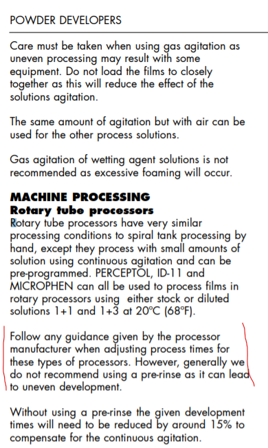

When you read this, consider the likelihood that Ilford uses "not recommended" in a very English way:
Actually, Ilford says this: "We do not recommend pre-soaking films prior to development since there is a small chance it can lead to uneven development."
But that is only found in relation to continuous rotary processing.

Here's what is written (with no caveats):
ILFORD FILM FAQ'S
SHOULD I PRE-SOAK MY FILMS?

I think though, that people read "not recommended" as being identical to "best not to do". Ilford does use the "best not to do" version in their references to pre-rinse in the context of a continuous rotary agitation procedure.
But that's exactly what it means. Had they written the word 'forbidden' it would mean "never do this"; had they used the word "optional" then it would mean what you want it to mean.
It would help if you would cite (link) to where there is a caveat for rotary processing because the Ilford FAQ, as previously presented, does not have such a caveat.

Using the ID-11 datasheet as an example, there is no reference to pre-wash in any section of the development instructions except for with respect to respect to rotary agitation:
The ID-11 datasheet is consistent with any I have read - the only time they reference pre-wash is in the context of rotary tube processors. They don't even reference it with respect to tray processing sheet film.
... okay... thanks for that data sheet... so how to you explain the FAQ?
... and I agree... all of the other Ilford processing instructions and guides are silent on pre-wet or pre-wash or pre-rinse. That doesn't lead me to conclude much of anything other than they are not recommending it.

I am not able to do so - it is a relatively new addition, and certainly wasn't there when these discussions (on APUG) involved Simon Galley.
I'm blessed/cursed with having been trained in contract and statutory interpretation. Among many other things, it is a principle of interpretation that if something is referenced in only one section of a document, and refers to that section, it doesn't apply to the rest of the document. Thus my reading of those data sheets.
Me too. In fact, I wrote that kind of stuff too... engineering policy and standards. (and it really is a weird mix of blessing and curse.) I'd state it slightly differently to say the same thing as you said, "if something is referenced in only one section of a document, and refers to that section, it specifically applies to that section."
If the other sections are silent on the topic there are no implications that can be inferred from other sections. Silence, for us, sometimes resulted in contractual conflict because differing interpretations of what that silence implies. But in the end... silence is not directive nor is it implicative... it's either intentional or an error/omission and until something specific is written doesn't say anything. You know that!
Simon didn't say much either that is definitive or particularly authoritative, other than to support Michael's posture that If you pre-soak and don't have any uniformity issues, or don't pre-soak and don't have any uniformity issues, there is no reason to alter your process.
