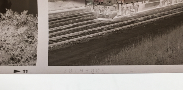

Alright, only the 4 rolls of Kodak Black and White 400TX were effected with the watermarking issue. I did shoot several rolls of color (some Kodak and some fuji) none of the color rolls have the issue.
I looked on all the rolls effected, all along the edges but saw no emulsion number. (?) The only number that appears after the 11th frame is the 12th frame.
As far as the backing paper and making a positive. All of this film was developed at a lab, so the paper is gone. Like I said, I'm no pro and haven't worked up the nerve to develop film on my own yet (although I did purchase the materials to do it - that seem much easier than actually taking the leap and doing it!). However, I'm glad I didn't develop this myself as I would have thought I messed up and caused the watermarking. So, I'm glad to have used a lab and even the 'pros' had this issue. I wouldn't have looked for this particular answer if I thought I had caused it due to my inexperience. So, looking at the bright side. This film was pretty old before it was used. I've ordered another 'pro pack' from B&H and noticed that the backing paper is now white and, I'm not sure this will make any sense, but the numbers seen through the viewing window (I'm currently shooting with a Holga for something different) look 'different'. They seem smaller or thinner - if that makes sense. So, hopefully I'll have a 'new' backing paper that will have the issue resolved. I'm about half of the way through the first roll, so I'll find out pretty soon!
I just had a look at a roll of TMY I have and the number is about 1/2" to the right of the 11 frame number on the bottom of the film strip. It's quite a bit fainter than the frame numbers. Hold the negative against a white piece of paper or strong light and you will see it. The numbers are very "computer" not like the frame numbers. See the photo of a neg strip, the emulsion number is visible.
WOW, I sure didn't see that. I held the strip up to the light, but I'll try putting some paper behind it. Thanks!
I seem to recall that prior to some point in time that emulsion number was actually stamped in that same location with a sort of knife-edged die and not optically printed. In that case, reflecting light at an angle off the surface helps. (But I believe rolls that old were not exhibiting the problem.)
I had 15 rolls of 400TX from a dubious batch and had them replaced, but I have since used three or four of the questionable rolls on local, repeatable shots and not experienced a problem. My impression is the Tmax films were most sensitive to whatever the problem is. I have shot a bunch of 35mm 400Tmax this year, but have never really gotten into the stuff for 120.
That is not unusual nor a problem.
Alright, It took a strong light and magnifier, but I was able to find the emulsion number which is; B08710. 2 of the 4 rolls have a very dark 'stain' over the emulsion number, but the other two have this same number, so I assume that each 'pack' uses the same number. Of course, I have no idea what the number means, but that's what it looks like to me.
