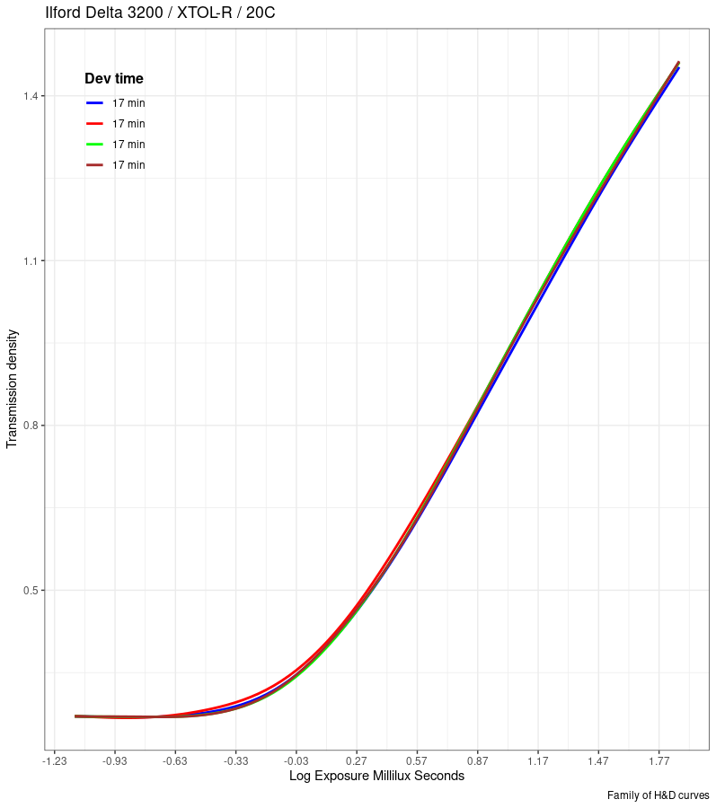

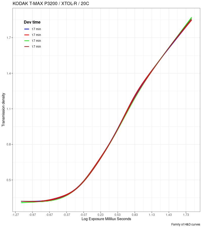

Though I am fairly new to replenished XTOL, I have found it to be very stable, once it's been seasoned. Here are the results of four subsequent seventeen-minute developments of KODAK T-MAX P3200 and ILFORD Delta 3200 in XTOL-R. As you can see, the developer is very consistent. It produces well-formed curves, which can be simply interpreted as very nice tonality. It is also clean-working and produces very fine grain with respectable sharpness. I am currently testing T-MAX 100 in XTOL-R and, so far, I am finding it to be a great pairing.
View attachment 324537View attachment 324538
Do you have a curve for Tmax 100 in XTOL (not replenished)
