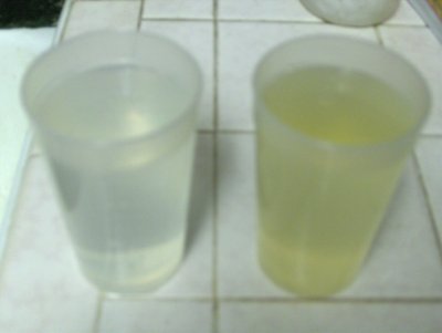

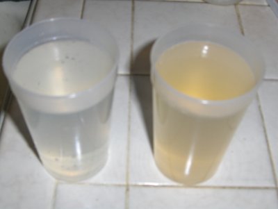

A new order of Tmax-400/35mm arrived from B&H today, and it's also from batch 0166. As before, it pours out yellow. Below, I attached photos of XTOL that's fresh (left) and used (right) so you'll know what this yellow colouration looks like. The two photos are with and without flash:

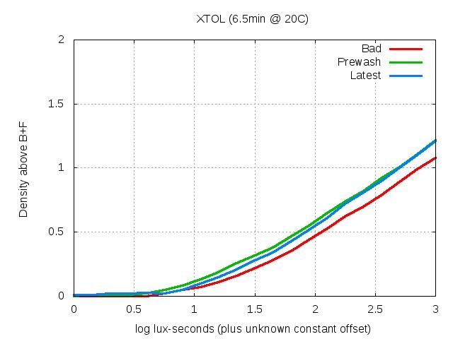

The roll is now dry, and I measured it on the densitometer. Here are the graphs of a failing roll, a roll with pre-wash, and the latest roll:
On the right-side of the graph, the pre-washed and latest rolls have the same densities, and both are above the failing roll (red line).
An interesting observation: The pre-washed roll has slightly higher speed, because its toe is higher. I suspect this is also true in Palec's tests, where the thin areas were noticeably denser in his pictures.
