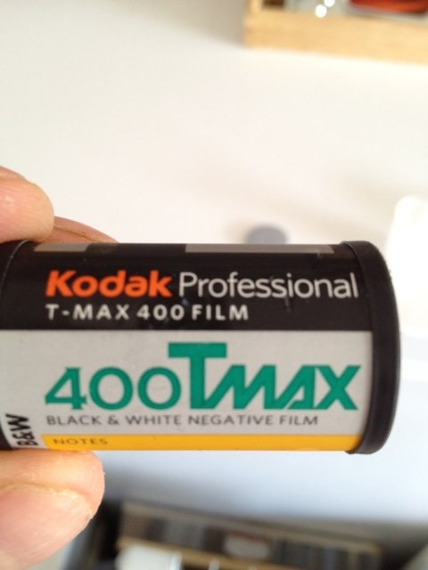

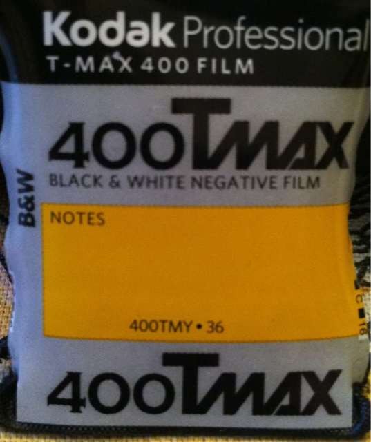

This is getting weirder by the minute. Seems Kodak changed the cartridge design, using only black ink, probably to save cash.
The black ink one is from the 2014 expiration one that Mark sent me, and the other one is expiration 2013. First I thought they had mistakenly packaged old TMY in the packet.
Tim Gray
Sep 2, 2006
1,882
OH
View attachment 49515View attachment 49516
They did that to Tri-X too. Sometime in the last year as far as I can tell.
