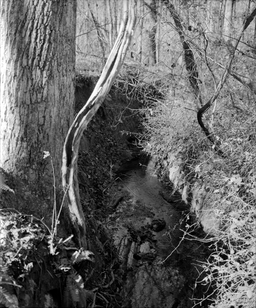

The Catlabs X Film 320, on the other hand, looks really good. I shot this roll at EI 125 (I'll probably go up to 200 on the next one, which is "box speed" for the Aviphot 200 they're repackaging), developed 15:00 with agitation every 3rd minute in replenished D-23, which seems just about right.
RB67, 90 mm f/3.9 Sekor C, Catlabs X-film 320 (EI 125), D-23r 15:00/3 min agitation. Negative scan.
Longs good! I would say you have it about right. Box speed on Aviphot 200 is for aerial use, and on the ground it’s more like 100-125. Given the nice results I personally would not change how you’re exposing it.

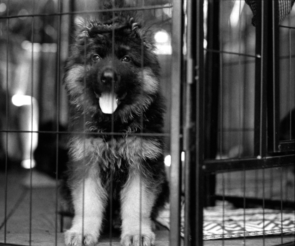

You might be right. Probably are. I clearly need to do something about light seals in my film backs, though -- I thought I had the Mamiya ones covered with electrical tape on the hinge, but I'm not sure which back this was (RB67 Pro or Graflex RH10?) and they both need some seal work. Anyone know if @Mamiya_Repair does light seals? I've got some material, but I'll probably never get around to it...
But this was from the roll of Ultra 100 in that tank...
Pancake, 11 weeks old. RB67, Sekor C 90/3.9, .EDU Ultra 100, D-23r 15:00/3 min agitation cycle.

Pancake is a special dog -- his mom stepped on his head when he was about 24 hours old; we thought we'd lose him, but the steroids it took to control swelling and inflammation messed with the growth in his hip joints and he's not only a little brain damaged but doesn't walk or jump very well. He's very sweet, though, and tries his best to please his humans.
