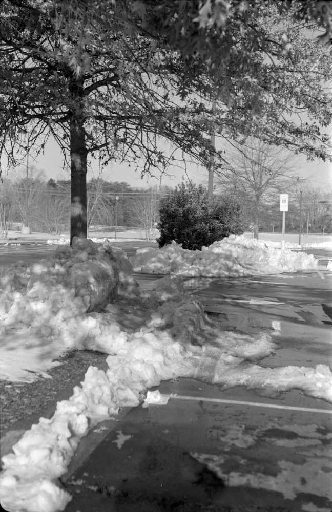

Okay, got the scanner uncovered and dusted off (living on a dirt road is bad for photography!). Last in, first out, at least for the moment, here's a frame from the (half scanned) 220 roll of GP3 100, shot in my RB67 (90 mm Sekor C) using a Graflex RH20 back. I haven't seen any problems so far that I'm reasonably sure are due to film defects (vs. dirt on the scanner glass or my own greasy thumbprints).

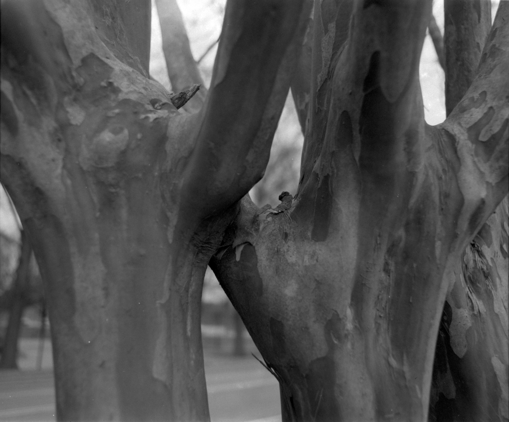

Got another roll scanned tonight -- this is the one shot with the RB67, 50 mm lens plus 0.45x filter, and a Graflex 23 back (hoping to get the 6x8 frames without laying out for a 6x8 Mamiya back).
I have a little vignetting on most frames of this roll, likely due to the housing of the 0.45x filter intruding in the corners of the field, and the aspect ratio of the scans (~7000x9000) says I don't have the 6x8 baffles in this body. Looks like I have a leak at the shell hinge; time to either apply some fresh foam or at least put a strip of electrical tape over the hinge.
There's also some barrel distortion in this lens combo (didn't shoot any on this roll without the filter, so can't say it isn't partly due to the 50 mm Sekor C, but filters like this are prone to it), and of course I've got soft corners (again, can't say it isn't partly the lens, but this kind of filter is also prone to that, due to field curvature). Still, it's Pretty Danged Wide...
RB67, Sekor C 50 mm, 0.45x filter, .EDU Ultra 400, D-23 Stock.
