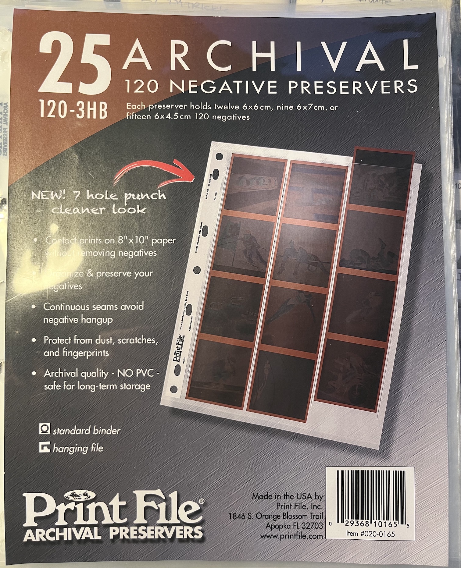

Does anyone have a good lead on negative pages that fit 6x7 better than the ones I have that are perfect (no extra space) for 6x4.5, 6x6, and 6x9 (4, 3, and 2 frames per roll respectively)? The best I've managed with 6x7 is to cut alternating 3- and 2-frame strips and let the longer ones stick out just a bit.
You want these, where the sleeve is turned sideways:
Still not perfect, but only one frame extra and I usually slide it in behind one of the others.
