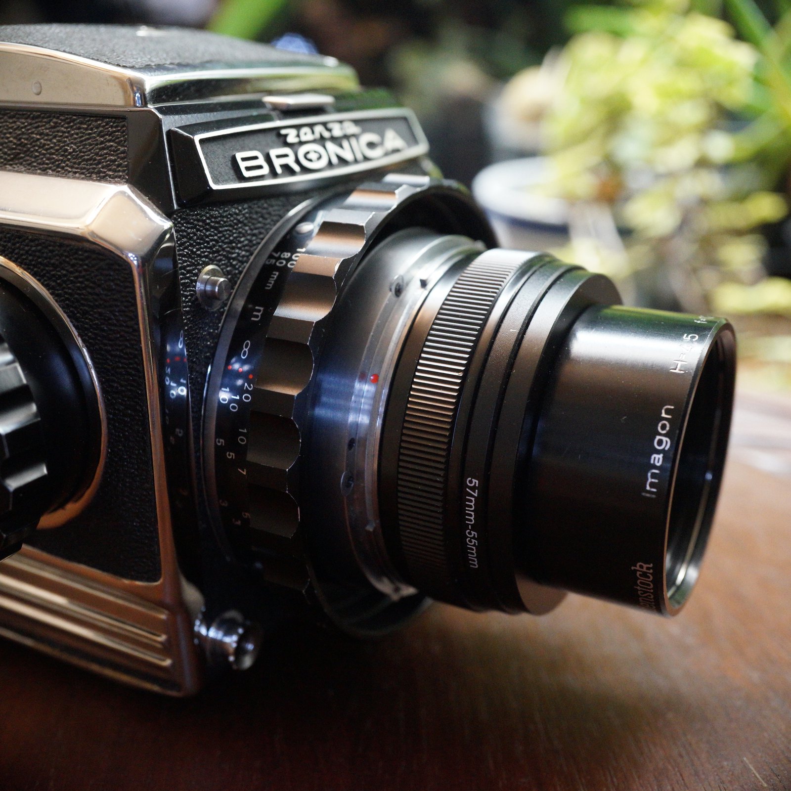

S2a with a Rodenstock Imagon 120mm h/4.5
The focus helicoid is racked out so you can see it, C-C macro ring, 57mm-55mm adapter, 55mm-40mm adapter to imagon optical block
The C-C macro ring is used as a spacer, I could have used 55mm spacers instead.
The 55-40mm adapter can be switched with any size to provide the correct port size for a large format lens, or you can drill a metal lens cap. Just about anything can be mounted into the 57mm thread as long as you can find or make the right adapter.

If you don't mind me breaking this down.
Macro ring of some sort with a 57mm thread? 57-55 stopdown - 55-40mm and an optical block on the 55-40.
What is an optical block? And where can I find this macro ring? I have one but it's a smidge too big.

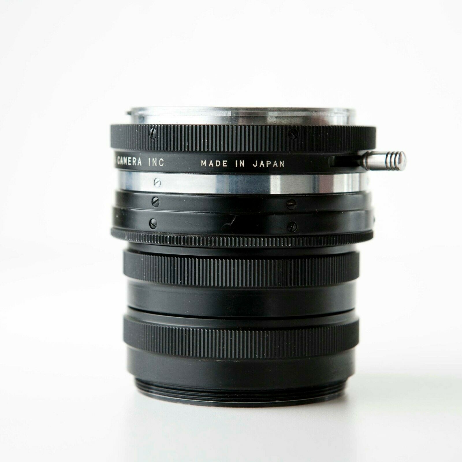

The Macro ring is a standard extension tube, with 57mm on both ends, male and female. It is not necessary, except to space out the lens to the correct back focus distance. I could have use a bunch of 55mm spacers. The macro rings were common for the Bronica S-series because they were necessary if you wanted portrait distance with longer lenses, as the helicoid did not extend far.
The set (above) probably came standard with the camera.
57mm-55mm adapter is visible, after the macro ring.
The "optical block" is the part that holds only the glass. The Rodenstock Imagon has one optical block, which threads onto the front of the leaf shutter (which is not shown). Most large format lenses have 2 optical blocks, one that threads in front of the shutter unit, and one that threads behind. The thread on the Rodenstock Imagon that I have is 40mm (which fits a Copal #1 shutter). Hence the 55-40mm adapter.
When you adapt a lens, you have to figure out how attachment to the camera (57mm in this case), attachment of the lens (thread or lens board hole), and spacing to provide correct back focus. It will be different (custom) for each lens you want to adapt.
