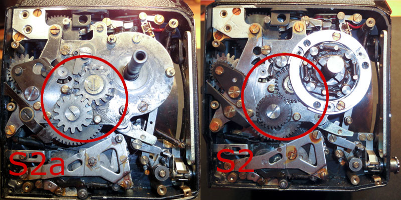

From what I read the S2a has steel film transport gears, rather than the brass gears of the S2 which apparently failed under heavy use....
This is a commonly repeated comment that is NOT TRUE. It was started a long time ago, and that statement has been repeated everywhere on the internet.
All Bronica S gears are steel, which is necessary to take the winding stress of the detente at the end of the wind cycle. They changed the shape of the gears under the highest stress on the S2a.
S2a on the left, S2 on the right.
The gears engaged to the wind knob (removed above) drive the gears circled, the entire load is taken on 1~2 teeth (typical of gears). Bronica enlarged the teeth on the S2A to accommodate a larger brute load.Typically the S2 gears were fine, but since it takes 4+ rotations of the wind knob to cock the camera, if you were in a hurry, you would wind on very rapidly and slam into the end stop (which has a significant detente to overcome). Because the amount of wind is variable depending on how much film has been shot (# revolutions of the wind know reduces slightly as the film is wound on) there is a tendency to wind hard till it stops (unlike a hasselblad that winds with exactly one revolution every time)
Just want to start correcting the "brass" gear story.
Thanks for the correction, and for the pictures, which show the difference! The S2a gears look far more rugged than those on the S2.
