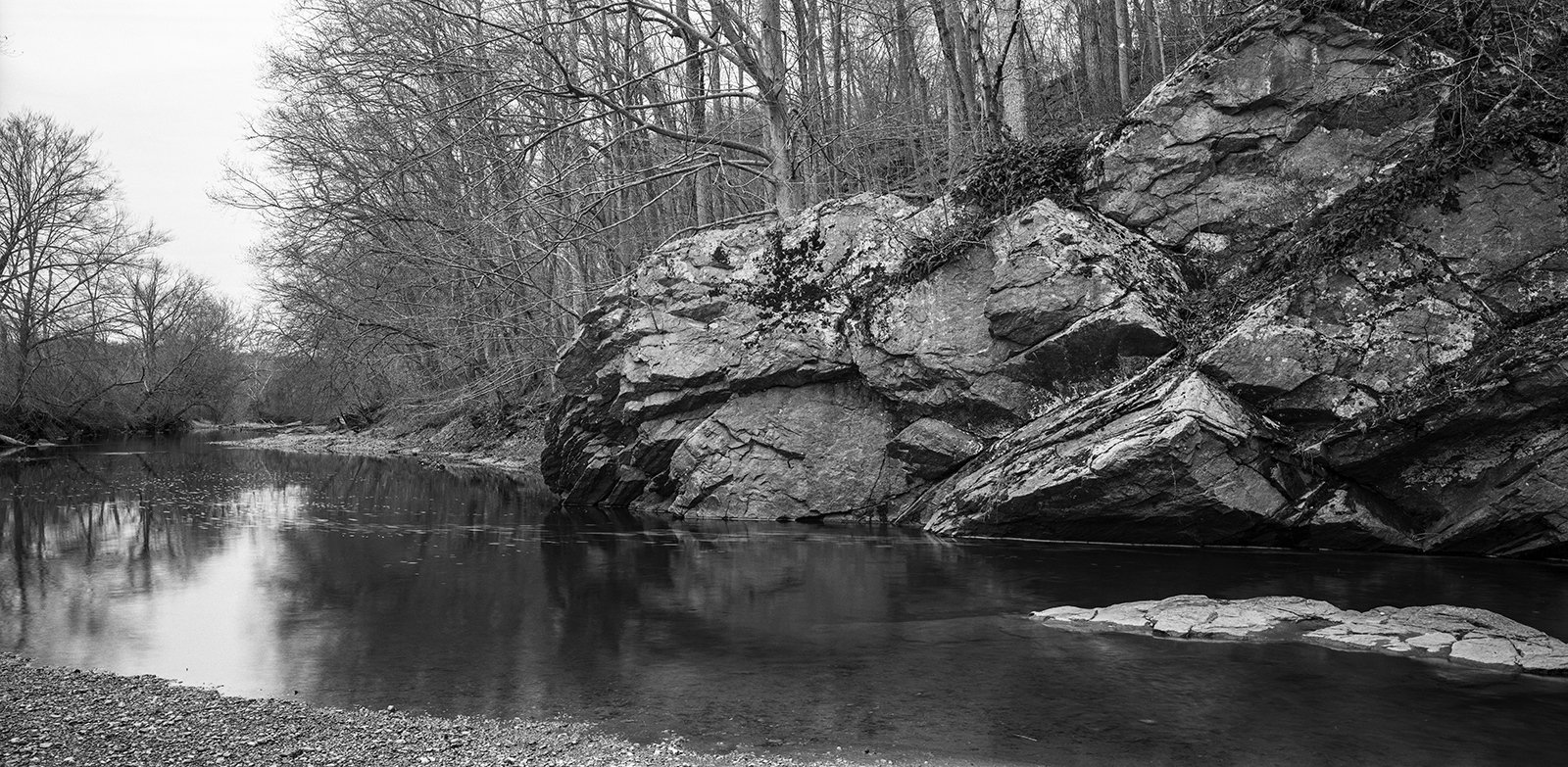

Finally, let me show you an example of Delta 100 (8x10 size) developed in the Thornton 2-Bath recipe: August 1, 2024.

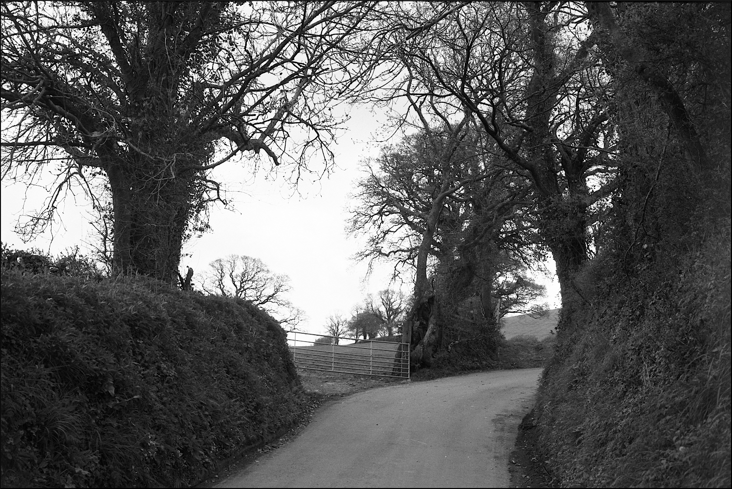

I like Delta 100 in 35mm for situations where the details matter. This is an example from yesterday, developed in BT2B. There is cloud detail in the negative, I just chose to play it down.
