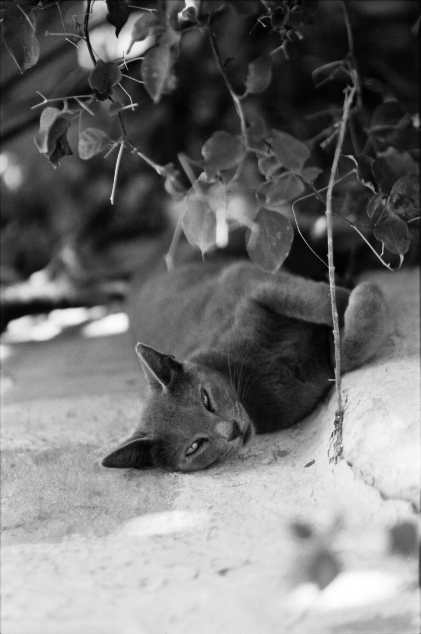

I'm not a big Delta 100 user, I like it in HC-110 a lot more than Rodinal. Looks pretty good in 510-pyro too:
To me it gives an 80s vibe.
