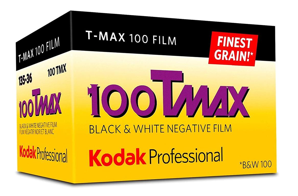

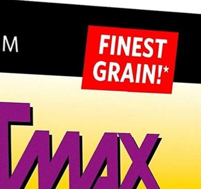

Ian - the characteristics of Tmax 100 vs Delta 100 have to be mentioned in regards of improvements to both films :
with regards:wink:

Possible you refer about Tmax100 not 100Tmax (with improvements) ?
with regards:wink:
