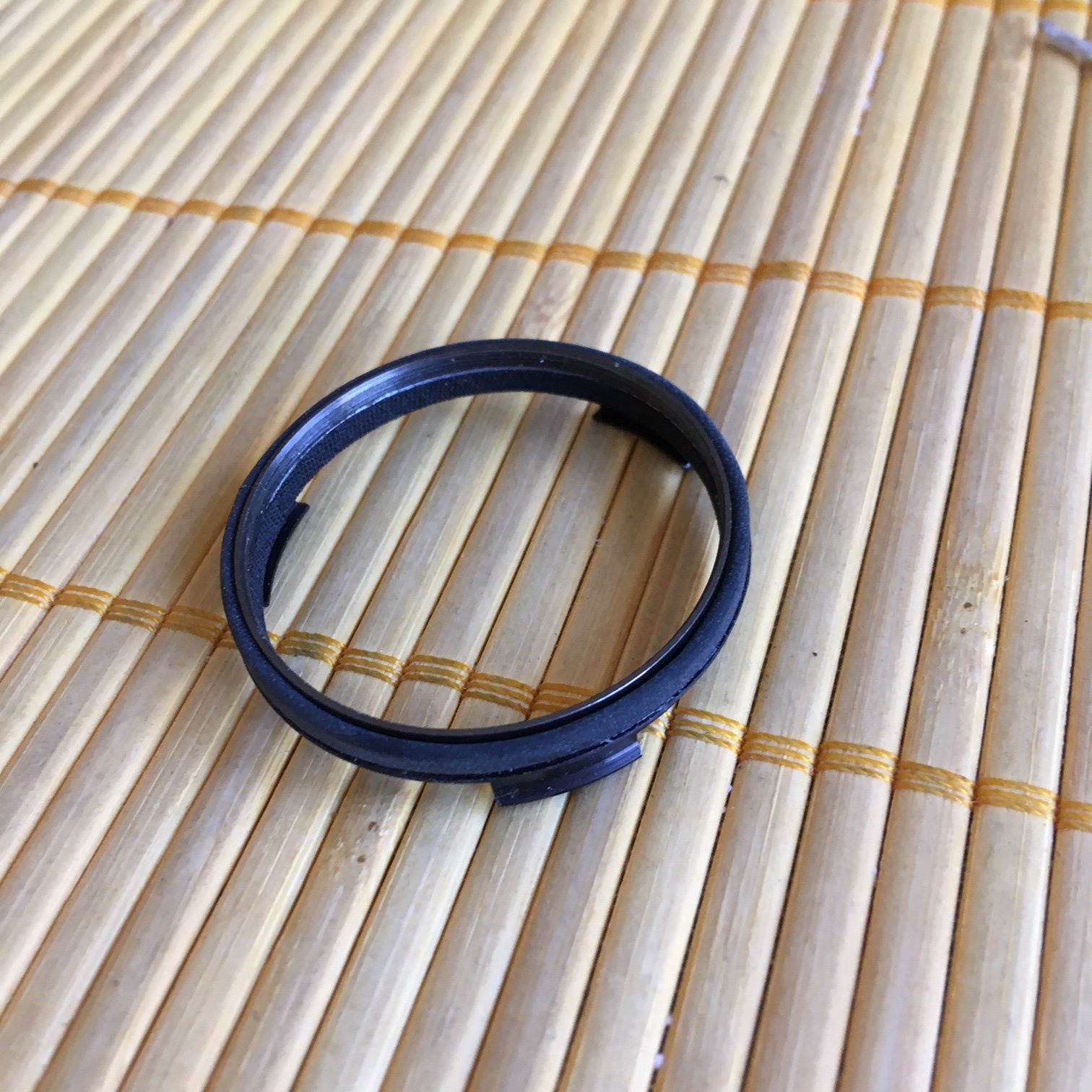

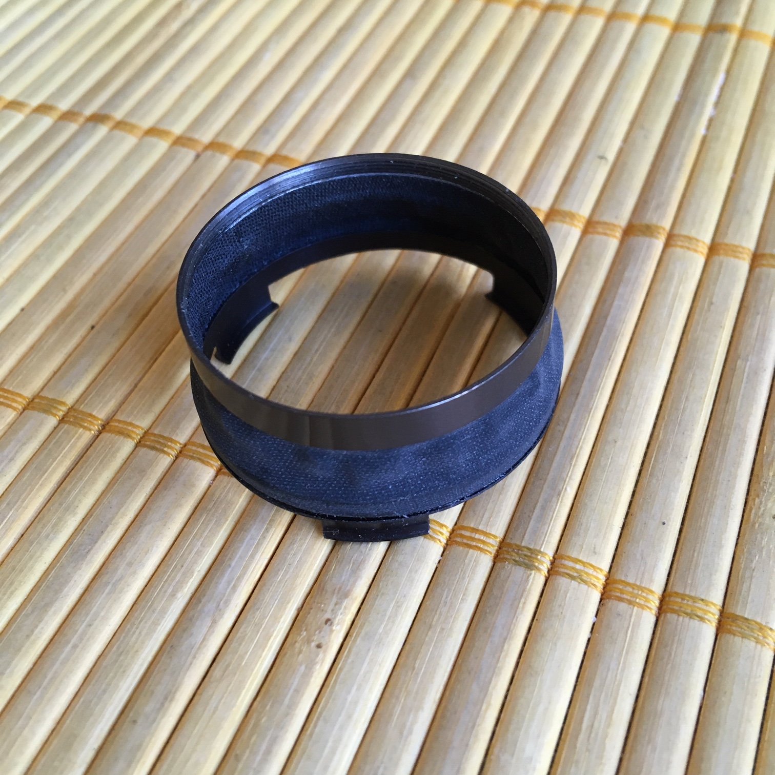

Below is the part. It is commonly referred to as a bellows because in between the top and bottom metal rings is a piece of clothe that folds in and out as the lens is retracted and extended (not for sale).
The discussion of velvet and such will get you nowhere on this model. It is not built like most other Rolleis (similar bellows are on the TeleRollei and some models of the 3.5F Rollei, not sure if it was random selection, using up parts, or what on Rollei's part). I've made new bellows like this using material cut from a changing bag. If you want a template file or a new piece of clothe, send me a note.
All in all I would send it back. Lots going wrong in that camera and you haven't even opened it up yet. If you haven't taken the lens panel off of a early '50s Rolleiflex before, the C is not a good model to learn on. More fussy than others, a few unusual decisions like the bellows, etc. Get an MX Automat and work on it first.

If I can bother you guys again I am wondering if repairing the bellows would be wise for me to do. Someone suggested using changing bag material which I have. From what I have read it is attached to the rear element and clipped onto the body. What I am afraid to do is remove the whole front assembly since there may be some spacers and shims involved and I don't want to get careless and lose them or not put in correct order since some may be different thickness. I cannot find any videos or instructions on removing the front assembly so I can get some sort of idea how it's done. I took one off an old Rolleicord but I don't think it's going to be the same. I am trying to self teach myself minor camera repairs and up to this point I have taken cheap TLR's cameras apart but never on an expensive camera. I repair copiers and printers so I not unfamiliar with disassembly but then I am working on parts that are usually larger than what's found in cameras and lenses.
shutterfinger
Feb 25, 2013
5,020
San Jose, Ca.
Changing bags are rubberized nylon or cotton and will be a good source of repair material if you have a bad bag provided the rubber is not failing off or you use a section that has pin holes. Use contact cement such as Pliobobd
https://www.amazon.com/W-J-Ruscoe-P-612-LV-Multi-Purpose/dp/B004JOYXR4/ref=sr_1_3?crid=V7FRPRQQEXJS&keywords=pliobond+contact+cement&qid=1574288197&sprefix=pliobond,aps,251&sr=8-3 which remains flexible when dry and any excess rubs off.
Follow the disassembly instructions for the 2.8 E in the manual link I provided in post 31. You have the skills, time to get some experience.
The shims stick to the back side of the plate or the surface they sit on. Loosen all mount screws, 2 or 3 turns, remove one screw and slide the shim out, put it on a piece of painters tape, fold the tape over and label it as to which position it was in. Repeat for the remaining screws.

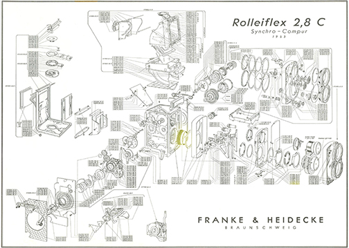

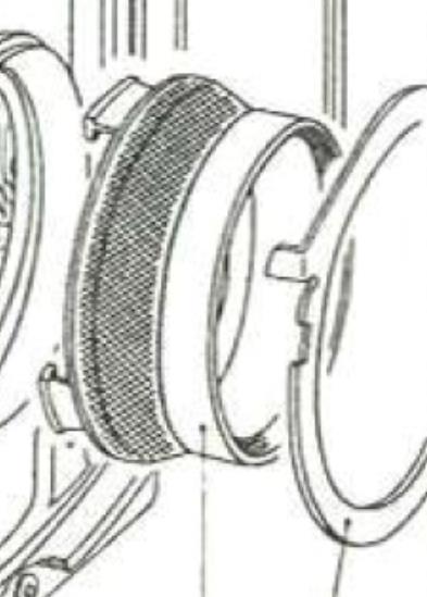

Do you happen to know how I should release the tabs that hold the baffle onto the body. Should they be done before I remove the front assembly?
shutterfinger
Feb 25, 2013
5,020
San Jose, Ca.
Never done one. From the looks of the photo provided by Dan it simply sits into place and turns like a bayonet filter for the camera or similar.
If you make a new one using the existing mount rings then make sure its the same diameter on each end and glue the ends of the cloth to the inside edge of the ring with an 1/8 inch / 3mm overlap and glue the edge. If one end is wider than the other then center the narrower on the center of the wider and cut the sides accordingly.
I just looked at the pictures (and diagram) again, the front slips on over the lens cell barrel and the back snaps into tabbed groves on the main body. Its a simple twist to remove/install setup. The front looks smaller than the rear so its either tapered or steped. Careful removal of the existing material should provide an adequate pattern. A patch should overlap the edges by a millimeter or two beyond the ring and be flush inside the ring. If I were patching the overlap would be on the outside of the light block tube.
