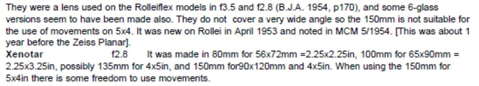

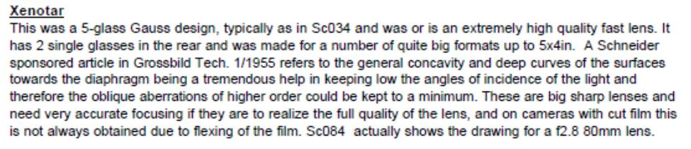

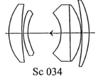

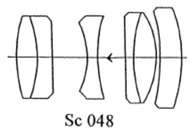

A lens Collectors Vade Mecum shows the Xenotar 2.8 as typically sold in diagram Sc034 and Sc084 as the actual 80mm f2.8 lens. There is no Sc084 diagram, there is a Sc048 diagram.
A repair manual I have shows the 2.8 C being from 1953. I would not pay more than $200 for it. Lens cells are matched and I do not recommend swapping cells unless you can optically measure them to verify they are identical.
Is Sc034 the Rolleiflex C design? Look as if the back group is not cemented. So on my part, the interior element is held in place by a retaining ring. Most likely the back element is rolled into the overall mount.

Rear lens: the f/2.8 Xenotars did not have a cemented doublet in the rear group. The 6-element f/3.5's did. I'd verify this first.

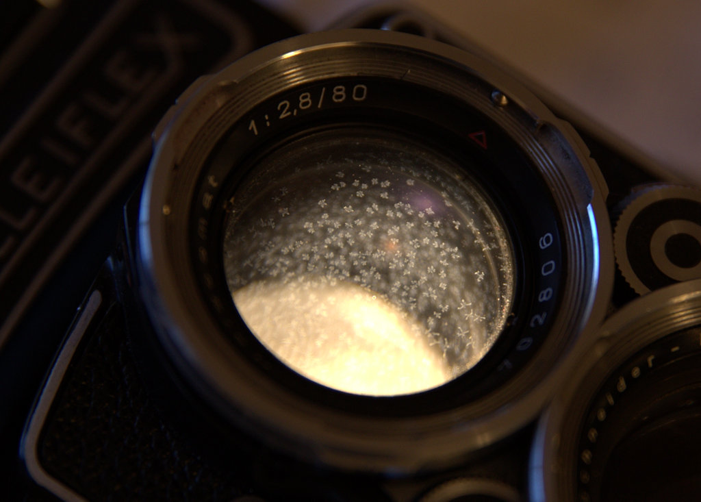

I received the camera yesterday and the lenses look foggy with a lot of whitish dots. The viewing lens is worse than the taking. Here is a picture of the viewing lens.
There is an element in the viewing lens that appears to be very symmetrical but isn't. Be sure to keep orientation when you disassemble.

That's fungus, and should clear out with hydrogen peroxide in a qtip.

I did buy it from them and they said it was lens separation but either way the elements would need to come apart to clean the fungus. I have a 30 day return and I have a roll in it now to test but I think the prints will be washed out. It's the removing the elements from the housing that I don't know how to do yet. If anybody has done this before I would appreciate some instructions.
Does the taking lens also have fungus? If so I think you should either return or get a partial refund. If you only had separation in the taking lens I would counsel ignoring it and not taking the camera apart. All it causes is a tiny bit less contrast from an extra air/glass interface and perhaps a strange flare if wide open. TLRs are more likely to be un-sharp from misaligned lenses than any kind of flaw in the glass of the taking lens. If you are dead set on fixing it I'd say send it to someone who can calibrate focus after putting it back together.
