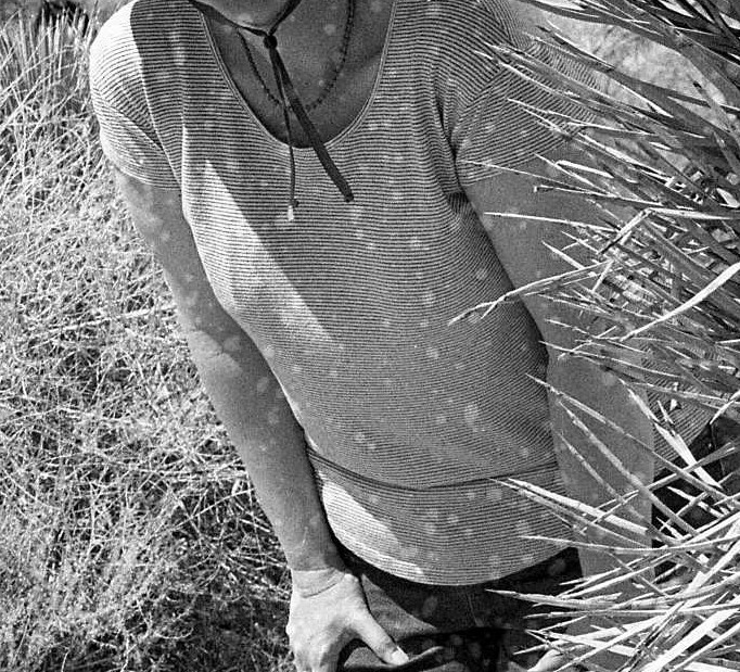

My film came out with a case of measles. Attachment is a small corner of a 6x6 but the spots are consistent throughout the entire roll.
HP5 120, no prewash, Legacy D76 1:2, 10min at 76f (too hot?), indicator stop, Legacy eco.pro fix 3min, rinse, arista hypo wash 5min, wash 5min, drop of dish washing liquid then air dry.
The negatives show no marking either side.
Afterward processed 4x5 negs in same chemistry... no marking.
I'll try rewashing and the alcohol rub, but I'm pretty sure its in the film. If it comes out I'll repost.
Has anyone seen such a case of measles?
This is an example of problems from the paper backing that most 120 films experienced recently. For a while the paper backing was changed due to supply changes and the replacement backing had spotting and mottling issues. There is nothing wrong with your development regime.
Thanks! I found the appropriate thread about Ilford mfg problems and posted there. Also sent Ilford support a report on their form. KInda makes you wish they would go back to supplying 220 again!
The header and tail for 220 film have more and bigger problems which drove up the cost adding to the demise of 220 film for the most part.
