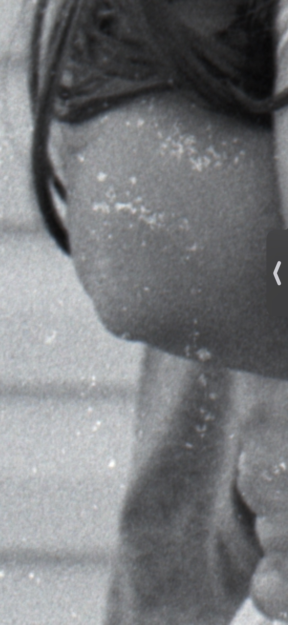

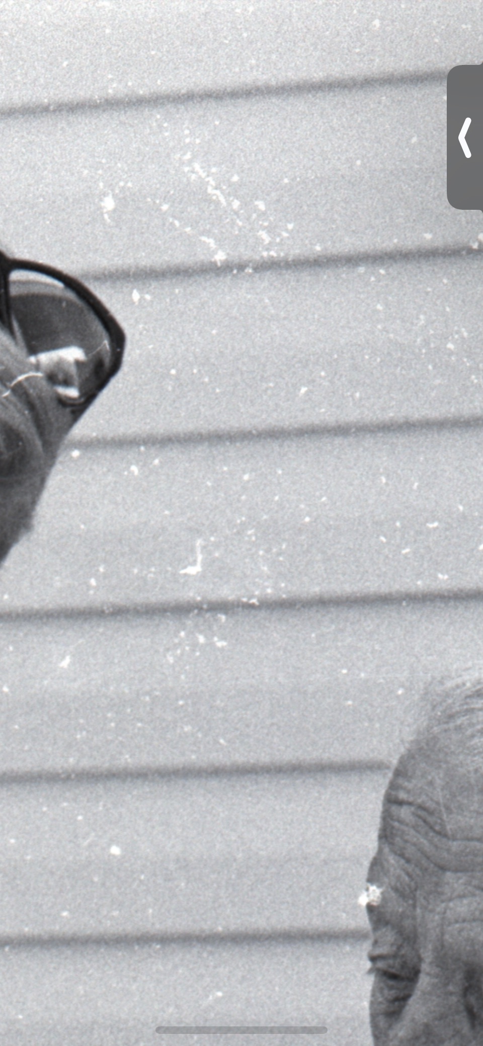

Second fix cleaned the the negatives. For some reason the sides perforation curled to a point getting tore in a few spots.
This is my development
XTOL 7 minutes. No prewash.
Kodak indicator stop bath.
ilford rapid fix
600ml water 2 drops of photo flo.
10 minutes Paterson hose wash.
Ilford wags 5 10 15 inversions.
but this time I did not do the Ilford wash and got bunch of water spots. aperently paterson hose for 10 only does not work as well as I taught. Or I don’t have the faucet turned strong enough.
But at least contrast looks good
This could be due to a problem with the film (cine perfed) getting cocked up on the sprockets in the camera. Shouldn't happen with Cinestill; theirs is confectioned for them (hence why they can offer it in 120) and has still film perfs, but if you're using 5222 from any other source...
Any case, I agree, nothing muddy looking there, but you've certainly got something in your wash water. Sloughing of oxidized rubber from the wash hose, perhaps? Or junk in well water, if applicable, or junk from your pipes.
I am at a new place. Yes it has to be the water. Cleaned with isopropyl alcohol cleaned almost everything.
I have to say I like the film especially with a flash.
I've added a detergent rinse step after fixing when developing films in 16mm; a small drop of dish soap with a modest flow rate and constant agitation until the water is clear. I sometimes see similar artifacts at high magnifications, probably due to remjet contamination in my case.
Maintaining the process temperature while washing the film can help prevent debris from adhering to the emulsion as well.
