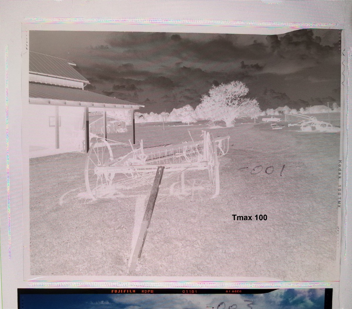

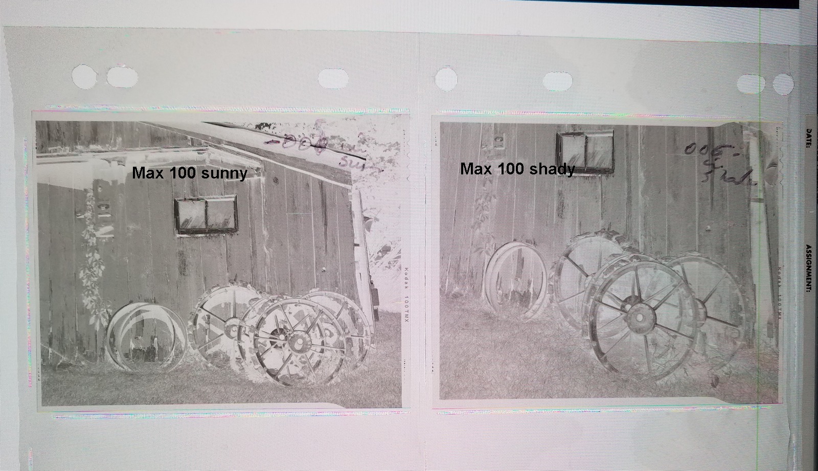

Here are (3) 4x5 negatives placed against the monitor screen and shot with my cellphone. Tmax 100
I see detail in the deepest shadows you've included in the "shady" negative, so they aren't any lower than about Zone VII. I wouldn't call that underexposed, that's about right. Depending on visualization, you could even have given one stop less exposure.
Just refixed. Trix Negs look clearer. Waiting to dry. Would be interested to compare before and after scans
It didn;t seem right as if it was too light. But it did seem to adjust ok in Lightroom. Thnaks.
