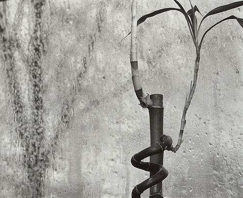

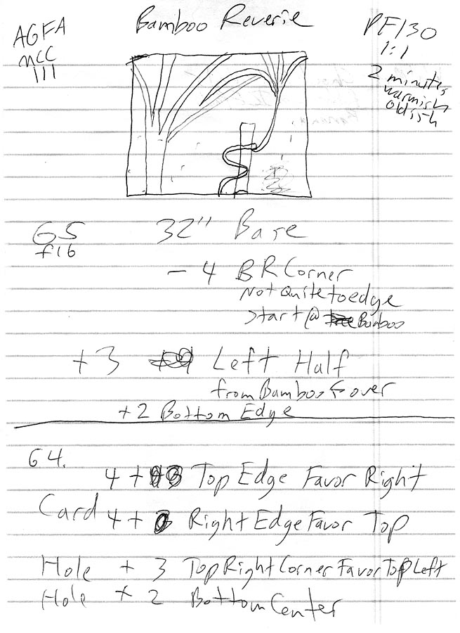

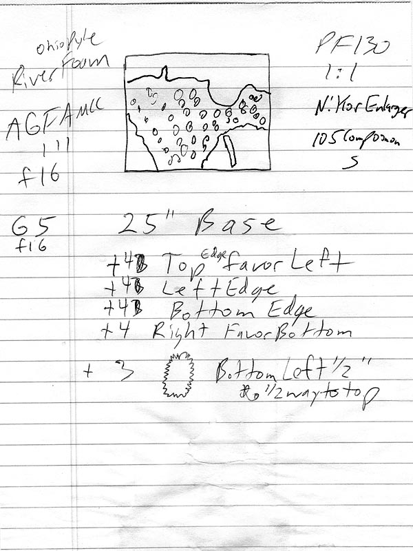

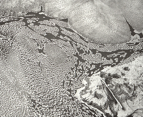

That's exactly right. I've attached a couple examples of "print instruction sheets" for two of my 6x7cm contact prints and oftentimes they are much more involved than these. I've found that taping or otherwise hanging a straight print in front of you while you work, as a sort of "map", can also help.
