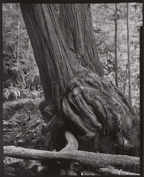

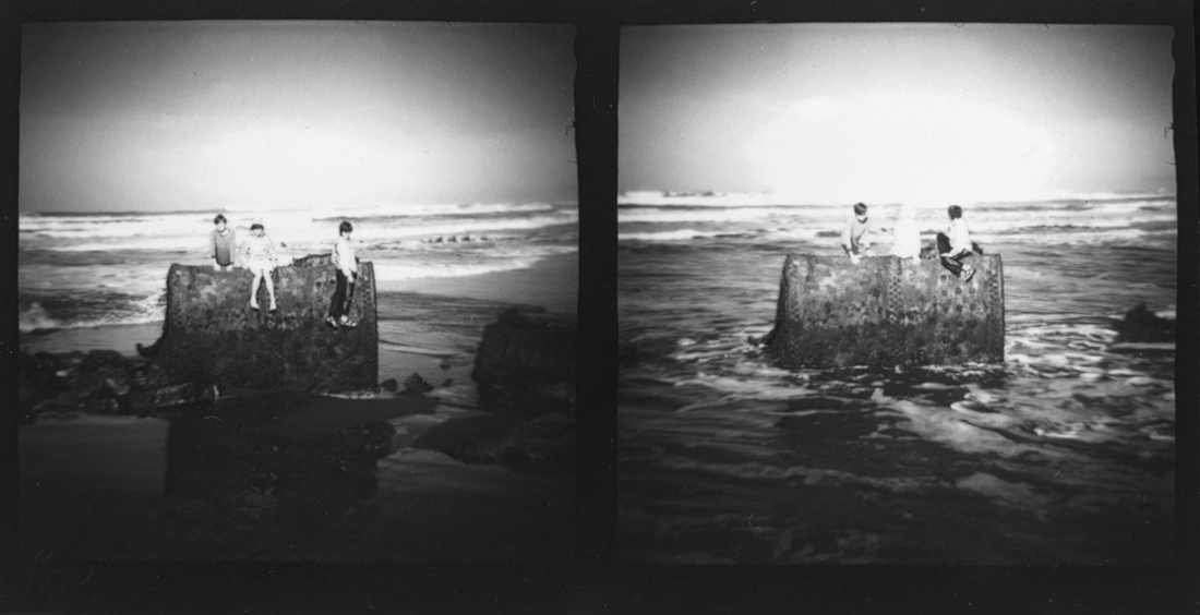

I have enjoyed making platinum prints and carbon prints from MF negatives. And I have started a project using 4x5 for carbon print images of an area I backpack into in the Redwoods. They can go on the wall, but they really shine when hand-held. Hand-made books are something I have been considering -- especially with the small platinum prints.
Below are two carbon prints...two side-by-side Diana Camera negs (so the print is about 2"x 5") and a 4x5 from the new redwoods project. Funny how one needs to shrink them on the screen to get the feel of them!

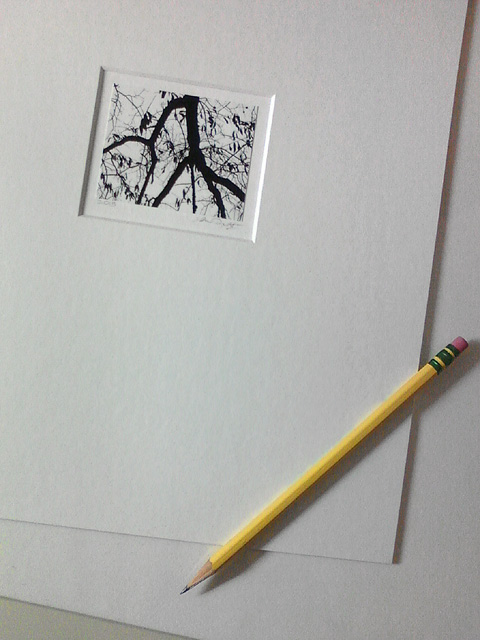

Do you dry mount the print directly on the flat piece of mat board?
I mount mine directly to mat board, trimmed to the image and over-matted with a small border around the print, slightly bigger along the bottom where I date and sign them. I've attached a cell phone picture of one of my 2.25 x 2.75 prints. I usually slip them into crystal clear bags, a stack of them is a nice thing to sit down with for a spell.
