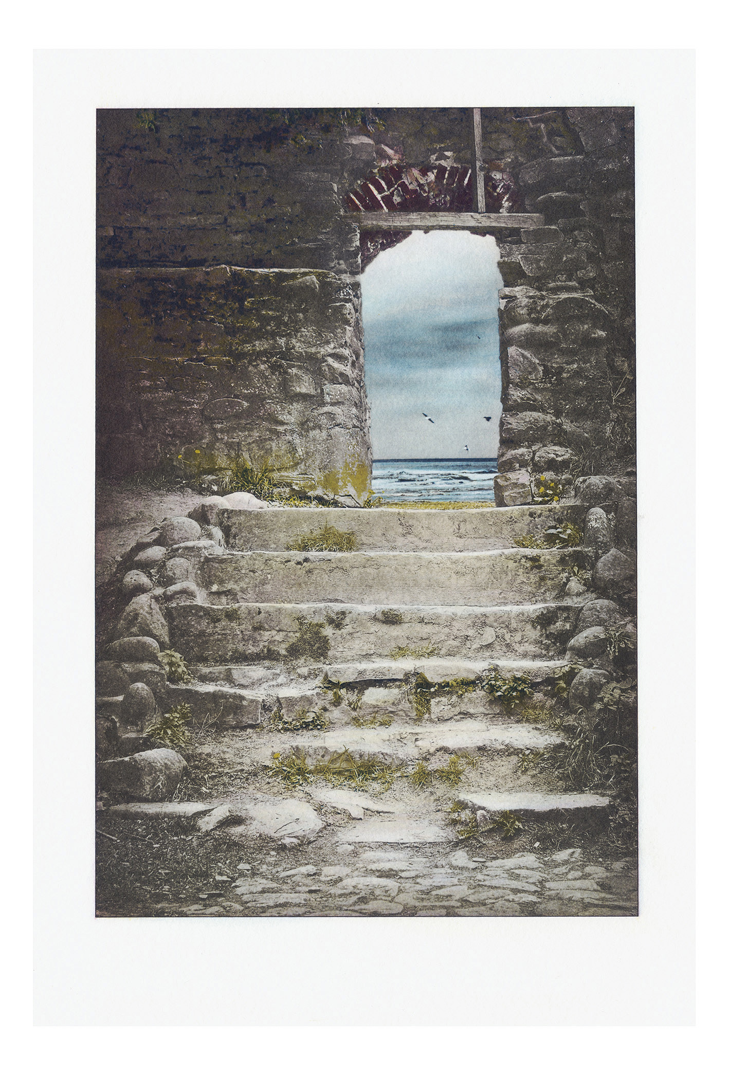

My second fish gelatin print:
Summer Memories​
The technical discussion is above my head.
But. While this image definitely does not have true colors, I like them a lot. Something between Technicolor and soviet-era color magazines.
Congratulations. Hope you can reproduce the exact process leading to this.

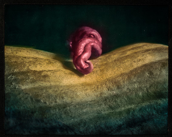

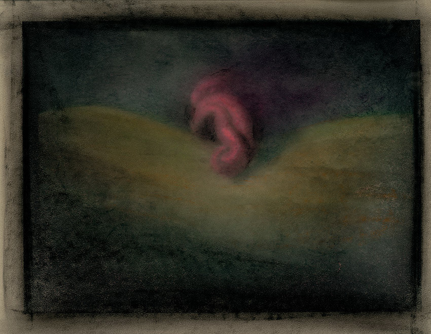

Here is work experimental, from an exhibition MHDEN AGAN it is PS-[free] based on a monotype - Lithographic [type] process.
1a is a bromo-oil
1aa based on a monotype - Lithographic [type] process
ooops typo...on photo [exhibition]

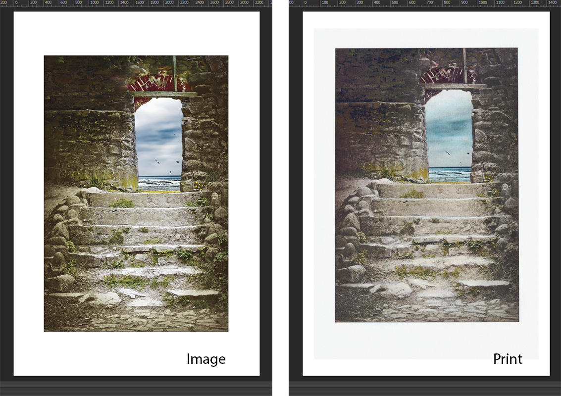

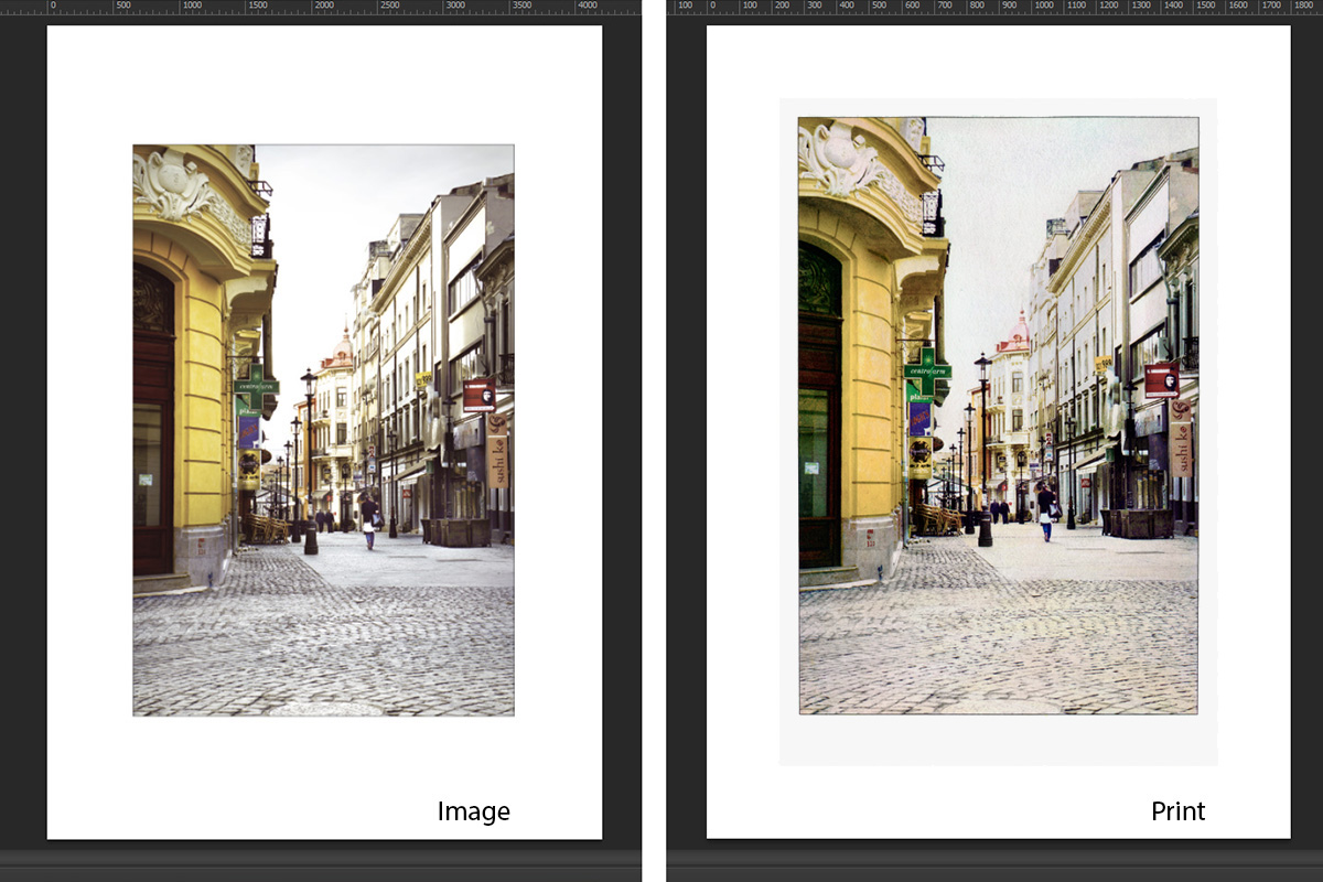

How colors are reproduced is an interesting discussion. Due to the specific pigments and the particularities of the process I don't think that a perfect color reproduction is possible. However, if the process is carefully respected a certain intended look could be obtained with reasonable repeatability.
Here are screen captures of the intended image and of scans of the prints:
For the first image, the print is remarkably (for such a custom process) similar to the source; maybe moire saturated colors.
For the second, the print has a character of its own: desaturated colors for the building, and a cyan shift for sea+sky; these two give it (IMO) its characteristic period look.
