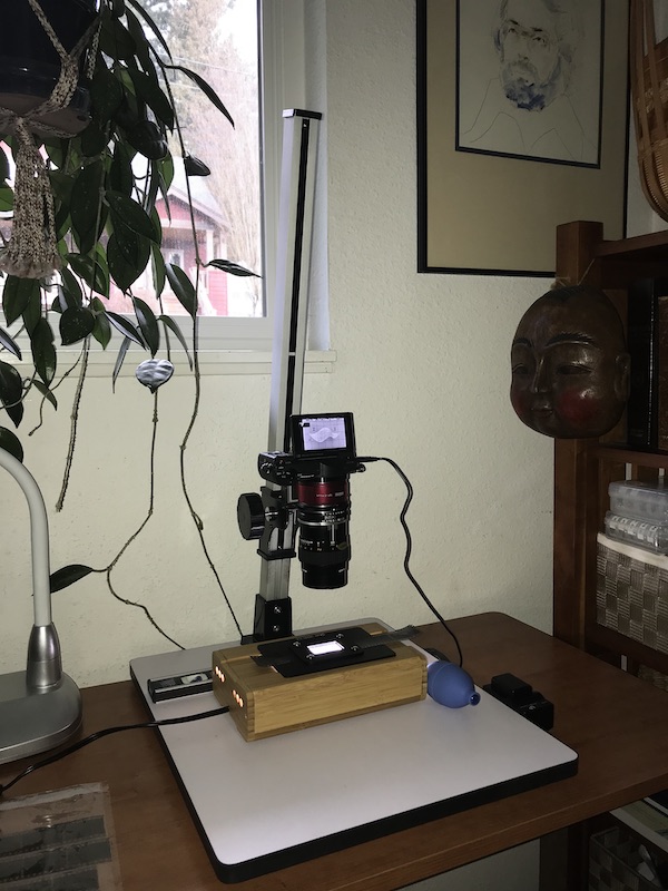

This was an intermediate set up in the ever evolving quest. It consited of a Sony A5100 I bougt for $150 usd, 55 Micro-Nikkor 2.8 Ai-S, Metabones adapter, a modifird Alzo copy stand and a Skier Copybox:
When I was finised with a roll, I could just pick it up and put it in a closet.

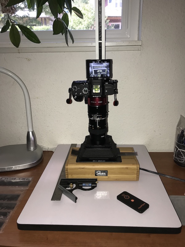

This was the last before I moved to the Negative Supply system: Sony A7II, 55 Micro-Nikkor 2.8 Ai-S, Metabones adapter, modified Alzo copy stand:

Sony A7II, 55 2.8 Micro-Nikkor Ai-S, Skier Copybox II
